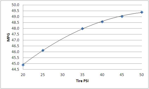

    There are some simplified equations you can use to see the general rolling resistance trends, I have posted before. Note that any specific tire would have its own characteristics. In other words, pay more attention to the shape of this plot, not the absolute numbers:
    I've seen some posts in Google, the hypermiling guru Wayne Gerdes used extreme high pressures (55psig+) he liked that. But unless you are trying to set the world record for miles per tank on a Prius (which some here are trying to do) I don't think we should go over-board on it. Main thing is MPG drops fast at less than recommended pressure.
    EDIT- The Mythbusters data gives a strange plot showing extreme benefit for going a few pounds over recommended. Something seems a little whacky in their data, but keep in mind each tire is unqiue.
    One big variable is tire temperature, whereas higher tire temperature greatly reduces rolling resistance (yet another reason why we see lower MPG in winter). I don't recall if Mythbusters talked about warming up the tires for 15-minutes before their tests, but that's what they'd really need to do. My plot is after warm-up. My plot of course is not perfect either ...I think my plot is estimating what happens to rubber rolling resistance vs. pressure. But I have no way to predict tire deformation vs. pressure, so that's where my plot could be off.
