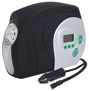

    AutoZone
    The first surprise was the range of at least eight tire pumps. Terrible brand name, 'Slime', I picked up:
    Same price as the Harbor Freight unit, it uses solid-state meter and micro controller. Set the target pressure and hit "Start" and it automatically fills to the set pressure. It still 'jumps around' like the Harbor Freight unit and needs better, rubber feet. Still, it stows the cables and hose within the housing and has a light. It topped off all tires and the TPS light went out.

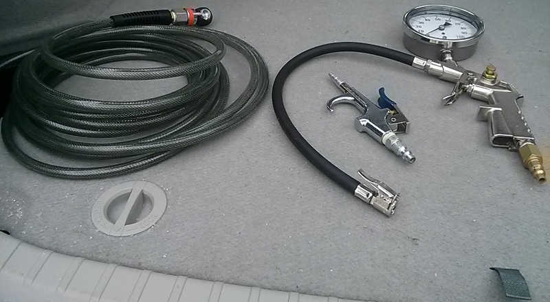

    The hose barb on that fitting is a bit narrow to fit US 1/4" hose tightly (it's made for Silca's own air pump hoses, which must be narrower). I got lucky with the blue, coiled nylon hose that I found at Menards, which is narrow enough it has to be softened with a heat gun to slide onto the Silca fitting and, once cooled, it is on there.
    The gray hose is a 25 footer found at Harbor Freight, billed as polyurethane to stay pliable even in cold temperatures, and that seems to be true; it's been pretty cold this week, and still uncoiled and recoiled nicely. The yellow/black wrap is to protect it where it goes under the plastic cargo tray. The coil lives in the small mini cargo tray on the left, accessible under the small plank without having to pull up the main deck board. It's long enough to comfortably reach all four corners of the car, use with a blowgun end to blow away junk around the engine, etc.

    Along with the hose coil in the left mini-cargo-tray, there live a blowgun attachment, and one of these nice trigger-actuated, thumb-chuck inflators with a big, easy-to-read gauge.
    Now topping off tires, or blowing tree gradoo from around hatch edges, etc., is as easy as reaching in the corner and pulling out the hose. Topping up a tire that's a couple pounds low takes only seconds. The spare-tire "reservoir" holds enough air to top up four slightly-low tires with the car off, and then the compressor will run for several seconds to make it back up when the car is made READY. If more air than that is needed, the car needs to be READY first, so the compressor can keep up.

    I bought a digital "Slime" brand compressor for each of our cars. For the price, they're definitely much better than others I've had over the years.

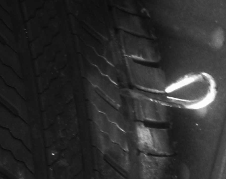

    A funny thing happened on my way through Ohio:
    It would have been a textbook application for a good tire plug kit, which I had even thought about buying back in April, but had never quite pulled the trigger, so there I was a couple hundred miles into a 600 mile trip, on the eve of the 4th, and it looked like the only place even open on the 4th to repair or buy a tire would be Walmart, so I drove there on the donut spare and camped in their lot until the tire dept opened.
    Thanks to the on-board air, the donut spare was exactly at 60 psi when I took it out at the side of the road. That was handy.
    I realized there was one thing I hadn't provided for when I designed that system. :) Once the spare tire is in use, the on-board air becomes unusable. I used the spare as the 'tank', and the hose to the spare's Schrader valve is just dangling with an open end when disconnected from the spare. For that situation, I would need something to plug the end of that hose, like a Schrader "tank valve" and a pipe cap:
    So, that's added to the 'accessories' bag now. I haven't tried it out yet, and I'm pretty sure the behavior won't be pretty (without the reservoir capacity of the spare tire, probably really rapid cycling on the pressure switch), but at least it may preserve some ability to use air, even while the spare is in use.
