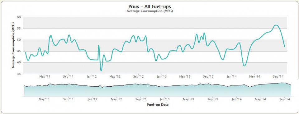

    My fuelly icon number summarizes data pretty much from day one, 5.0 liters/100km translates to 47 mpg US. That is a real mix of driving. In summer we do better, in winter not so much.
    That low dip just past Jan '12 was messed up refueling I think. And the drop at the right end looks kinda like the stock market of late, lol:
