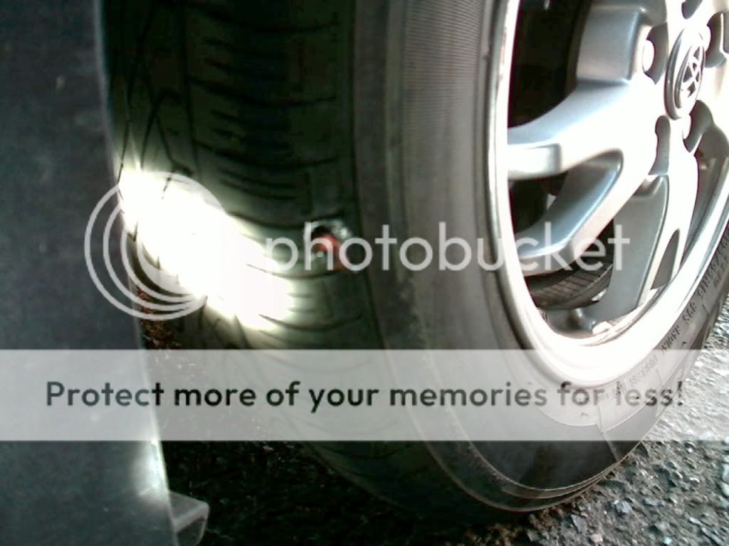

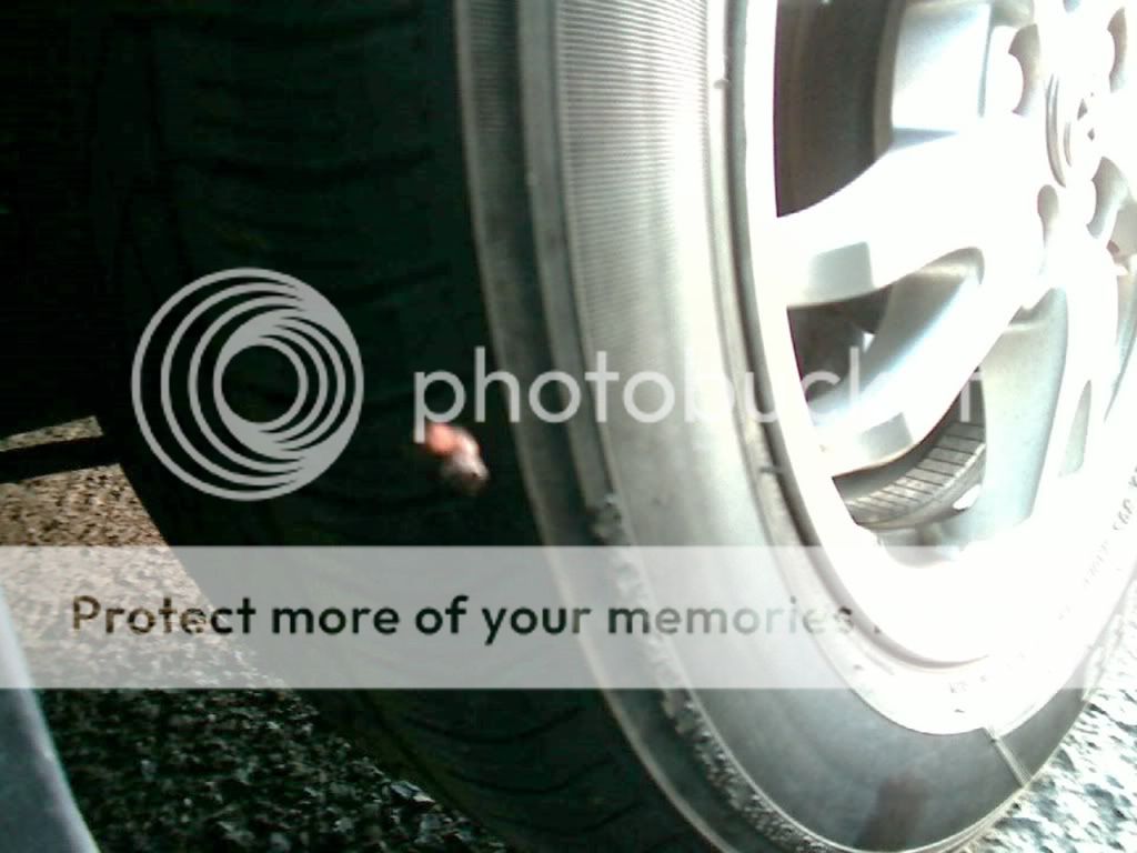

    Hi guys,
    My OEM Yokohama tires are now at 24k miles, and the rear driver side tire got a nail on the edge/side. I got a temporary plug right now, but is told not safe to drive much.
    Now my dilemma is:
    1. should I replace 4 tires now or only 2? (there is still plenty of thread left as I can see)
    2. What tires to use? I like Michelin Energy Saver or Hydroedge, but they are hard to find in stock right now. Also looking at Ecopia 20 or 422, but open to suggestions.
    What do you guys think and recommend? Anybody know any current promotion any stores have right now?
    I have to replace these before my vacation next week. Thanks

    Based on the location of the hole (looks like right on the edge where the bottom & sidewall meet, on the sidewall side), no reputable shop would repair that, even with an interior patch/plug; and even if you could find a shop that would, I wouldn't risk my or others safety for it.

    I've got to agree, that is too close to the sidewall to consider patching.

    Now we're digging deep into the anatomy of a tire. It's close but it's still not part of the sidewall. Anyways, when the mechanics take the tire off, they'll be able to determine if it's safe to patch.

    The repairable area ends some distance inside the outer edges of the tread:
    The puncture looks like it's in a bad place to me, and I personally would not be comfortable putting my safety in the hands of some tire jockey. Honestly, is your safety worth it?
