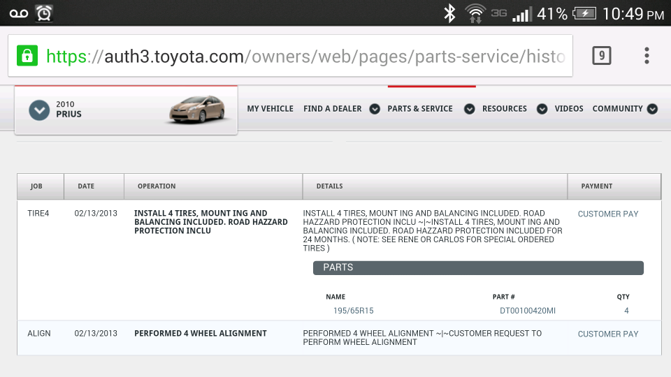

    Screenshot_2014-10-16-22-49-13.png I just checked the maintenance records. The tires were replaced on 02/13/2013 at 44k. I'm at 68k, bought at 64k.
    So they were installed over a year ago and already have >20k miles. Will the dealer hold this against me?

  9. The Electric Me
    The Electric Me Go Speed Go!
    May 22, 2009
    9,083
    5,798
    Undisclosed Location
    I don't quite understand the question.
    I'd suspect the dealership would be willing and should re-install the tires correctly.
    But if you aren't showing any abnormal tread wear, and you said the tires look almost new, then that is all I'd expect them to do.
    Yes, it appears a mistake was made, but you've only lived with the mistake for 4000 miles.
    There's nothing the dealership would be "holding against you"...
    All you did was discover the tires were at some point installed incorrectly.
    I don't know what your expectations are here.
    If you are going to ask for an entirely new set of tires? That might be a hard sell, if the tires look OK today.
    But I think you are being perfectly reasonable in wanting the tires orientated as the manufacturer suggests. Getting them changed around shouldn't be a big deal.
