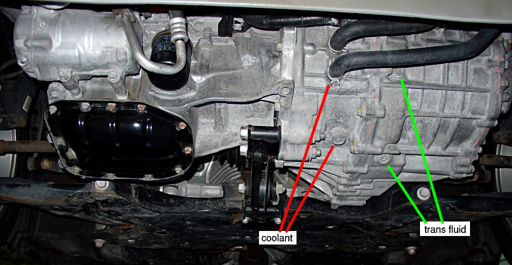

    Watch this video
    Now, the Prius has no clutches, it has no torque converter, and it has no valve body.
    Now watch it again ignoring the clutches, torque converter and valve body. There are now no downsides to changing the ATF.
    A simple drain and fill is going to replace over 90% of the fluid, so no flush is needed. Just drain and fill. Toyota ATF WS
    Picture of a gen 2 transaxle, showing the drain and fill bolts (always open the fill bolt first)
