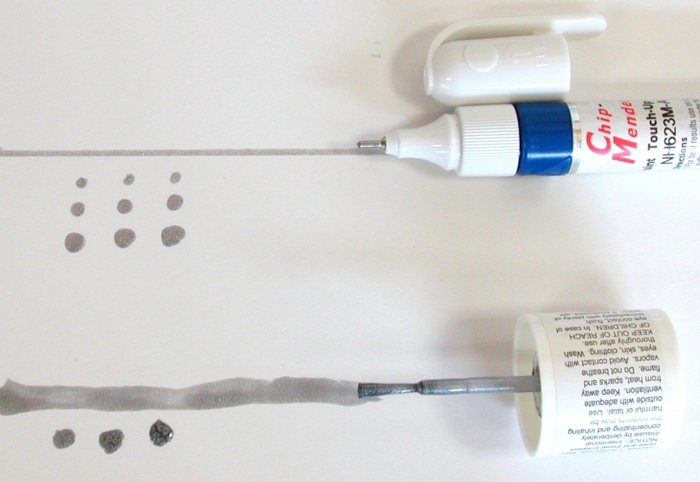

    Thanks Patrick. I think this is exactly what I was looking for. Here are all my points as a thank-you! :p
  8. Sufferin' Prius Envy
    Sufferin' Prius Envy Platinum Member
    Jul 7, 2004
    3,998
    You are welcome.
    I have the Chip-Mender link in my Firefox bookmarks. I'm just waiting until I have saved up enough chips - unlike PriusChat points, which I get rid of quickly.
    Don't worry, your points went to a good cause . . . someone who appreciates them and will "put them in a decorative wooden box on my nightstand as a keepsake."

    <div class='quotetop'>QUOTE(Sufferin' Prius Envy\";p=\"105351)</div>
    Am I supposed to order the paint color and the clear coat?

    Thanks for sharing the chipmender.com link.
    This is a great product to use with touchup paint too, maybe the 2 can be used together with better results?
