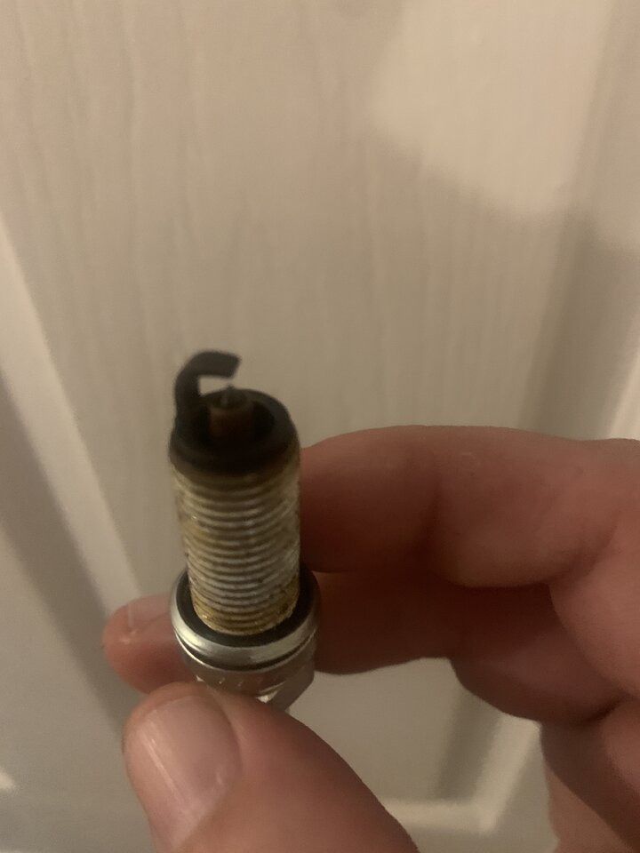

    hi everyone, i have a 2016 prius, oil change every 6000 miles. the engine light is flashing. the computer is showing a misfire code, the car shakes when accelerating. my friend says it's a head gasket problem. but the coolant doesn't go away, and the engine oil is fine, there's no water in it. does anyone have any ideas? is it the head gasket? thx everyone it only has 130 thousand miles on it, and i never drove it fast or aggressively we changed the spark plug and it was rusty, but it didn't help

    Head gasket problems have commonly been presenting as engine shakes right away on cold start, then smoothing out after a while.
    Shakes when accelerating (mid-load accelerating, not floored) might indicate the intake manifold EGR passages are (unequally) clogged, because those mid-loads are when EGR happens, not at idle and not when floored.
    Lots of other things also can cause misfiring under various conditions.
