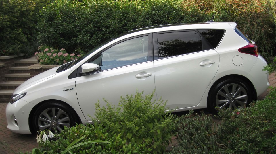

    This is the car for anyone who has not seen one.

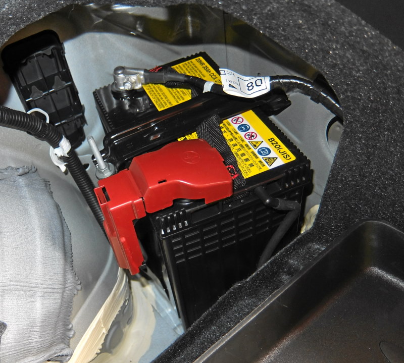

    It would be interesting to see a photo of the 12V battery showing the battery's model number.

    I have had this problem twice now, I think the battery is 35Ah.
    The recovery guy's report says "car charging at 14.5v and 30amps, 0.6Amps drain after 15 minuets" if I'm reading it correctly.
    The car is with the dealer now, but here's a photo of the battery.
    GrumpyCabbie likes this.
