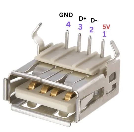

    No fuses likely but you could ohm out the wires. I give it 95% no internal fuse as Toyota and everyone else typically current limits usb charging power.
    It appears half of the wires go to the ext box and the other half go to the head unit.

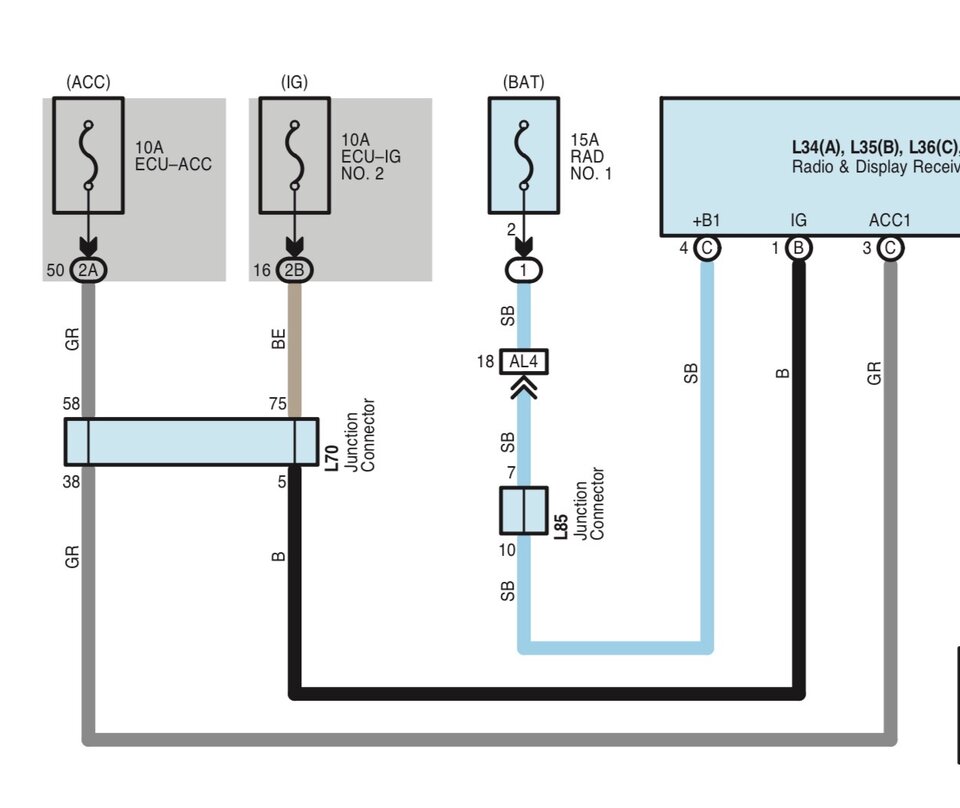

    First, I assume your car originally was cabled for a 57011 head unit with an ext module. So the cabling should be the same. But there is one cable that could go to the head unit or the extension module.
    Here are some pics of the wiring.
    Note the cable in between the two boxes.
    And a pdf on how to add an ext module
