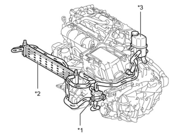

    Toyota Master Tech here, "Specialized Procedure"? Yeah right!! There's nothing to the transmission. No converter, no external fluid cooler, no solenoids. I've never charged more than half an hour to drain and fill a Prius. Maybe an hour tops if doing the Hybrid cooling system too. And that's still slightly longer than it really takes. I bet they were going to try and sell a "Flush" service.

    764
    The transaxle DOES have an external cooler.
  12. xliderider
    7,869
    3,116
    I believe that's the inverter coolant loop. ;)
    I believe the transaxle is cooled by passages in the ICE coolant loop.

    764
    Then, why is the drain right near the transaxle fluid drain?

    Yeah, you're probably right. :)
    Maybe I'm thinking about something I read in the Nissan Leaf thread, but that would also be the inverter coolant loop.

    764
    The coolant loop runs through the transaxle to cool it.
    It is very important that the coolant be changed, too.

    Yup, that's not transmission fluid running through it. All coolant. The ATF gets cooled by the SLLC running through the transmission then the radiator and finally the inverter. Hence, it's cooled internally, meaning the trans fluid never leaves the transmission. And yes, changing ATF can be done with the coolant. Their drain plugs are close enough to each other and it's the same procedure for both systems. Drain and refill.
