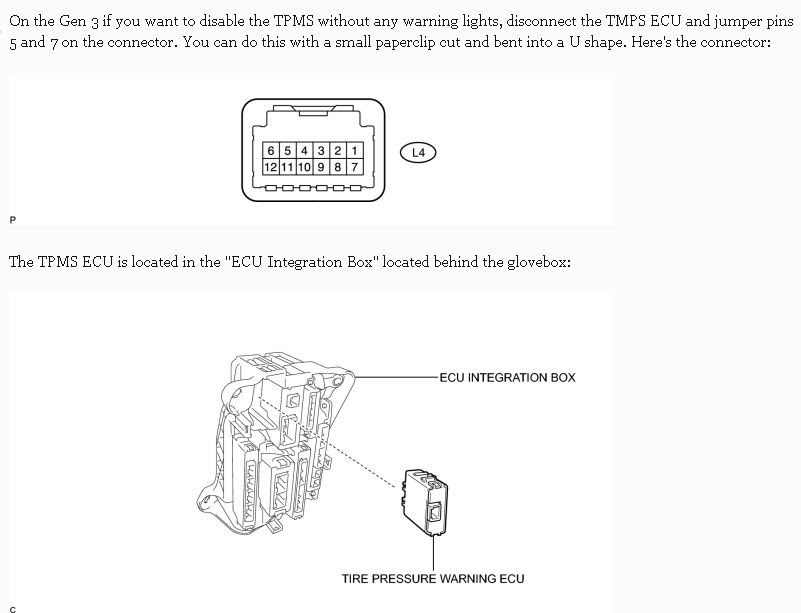

    electrical tape over the dash light is the most cost effective solution

    Replaced all 4 at Costco parts and labor for $250. Call ahead to make sure parts are in stock.
