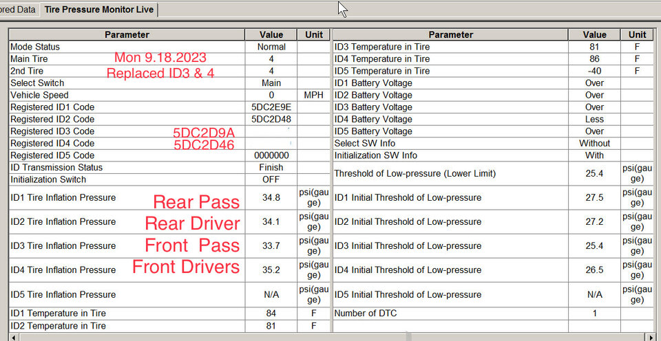

    While not the same interface as an Autel, the following represents Techstream monitoring the realtime sensor ids and data points (pressure and temp). The red notes recorded the changes I made.
    The sensor locations are not automatically populated in any particular order. If you had Techstream or similar and noted one sensor was offline you can reduce each tire's pressure by ten pounds and note which sensor id does not change

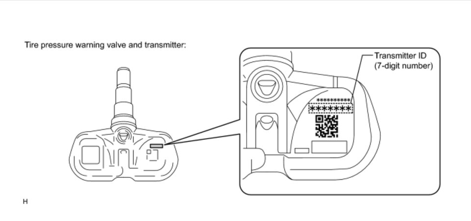

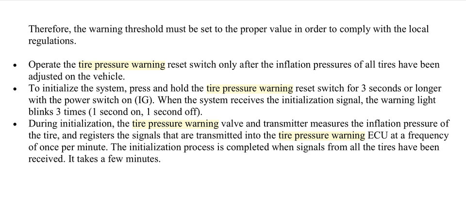

    The tpms reset switch is used with ig on (two power presses without brake). It takes the current pressures and sets a lower alarm pressure. It has nothing to do with setting up new sensor ids.
    Be sure to do this properly first but its unlikely to be your issue.
