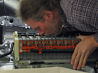

    There is probably no one who has investigated the traction battery smell situation more closely than hobbit.
    You might be interested in reading his write-up about it.

    As Bisco alluded, are you sure the smell is not from the rubber vent tubes? Seems like the link to that Hobbit write-up also identified the vent tubes as the source of the smell. If so, the fix is easy, simply replace the vent tubes. I did this with mine years ago with silicone tubes and the smell (urine like) was gone within a short time.

    But there have been prior posts about those vent hoses developing a strong smell, corrected by replacing them.
