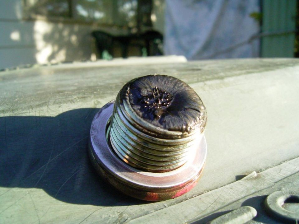

    Hey forum,
    I've been an anonymous guest for quite some time. I bought a pre-owned 2008 Prius with about 114,000 and recently at 126,000 miles changed the transaxle fluid. Thanks to +Patrick Wong, who convinced me (through reading his replies) to drain and fill it. I'm glad I did, a surprisingly noticeable difference in how its running. The magnetized drain plug, which has a lip, was completely filled to the brim with micro-debri (no large chips or shavings).
    To those who are on the fence and are mechanically, even in the slightest, do it (obviously do your "how to" research beforehand). I will be doing the same every 60,000 miles! Anyone want to try and convince me that 30,000 isn't overly aggressive (my feeling)?

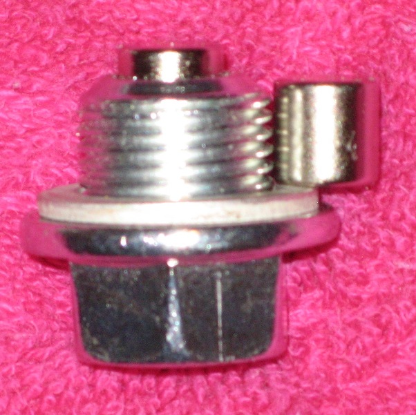

    I was a good find that it did not have a magnetic drain plug.
    All I know is that all of that metal floating around in the fluid DOES accelerate wear.
    Based on others, who have Gen II Prius models finding a lot of iron and steel caught by the magnet, I made my own with a much stronger neodymium rare earth magnet.
