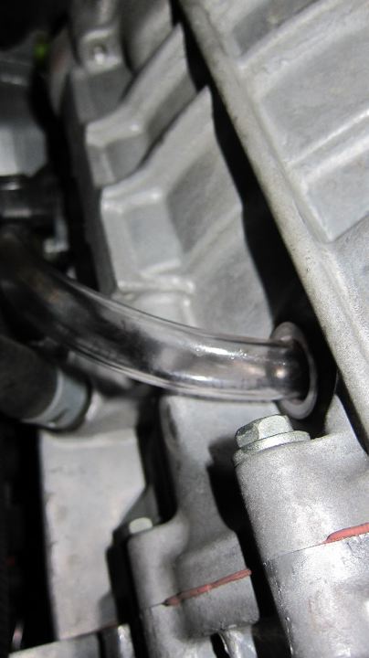

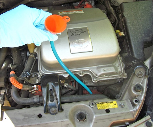

    This is a subject of ongoing discussion on PC. The general consensus is that despite Toyota's position, the transaxle fluid should be changed every 30-60 thousand miles. The procedure is not difficult. If you can change your oil, you can also change your transaxle fluid.

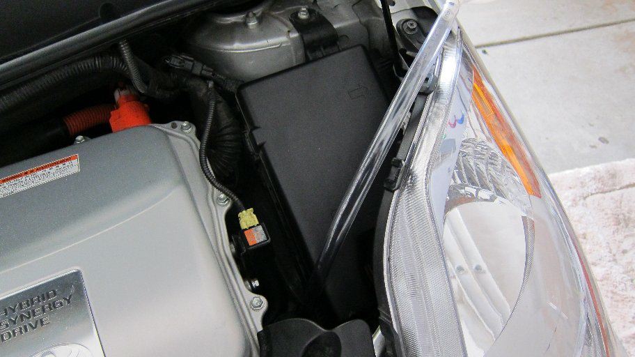

    Guides (you can ignore steps about moving/removing the inverter - just drain & fill)

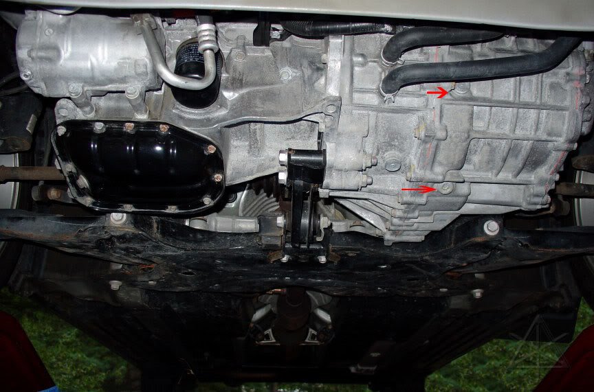

    Also, it pays to call the various Toyota dealers in your area to get the best price on the fluid. I will be changing my fluid soon, and dealers in my area quoted me $9.39 - $11.84 per quart.
    You will need 4 quarts of Genuine Toyota ATF WS (world standard) fluid - Toyota Part #00289-ATFWS

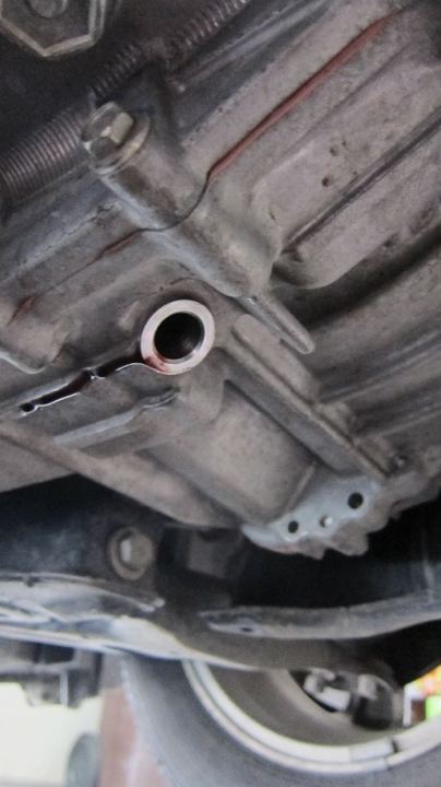

    It is also recommend to replace the crush washers on the drain and fill plugs - Toyota Part #90430-18008 (quantity=2)

    Be sure to open the upper fill plug first before the lower drain plug. If you do it the other way around and have a problem, you are left high and dry.
