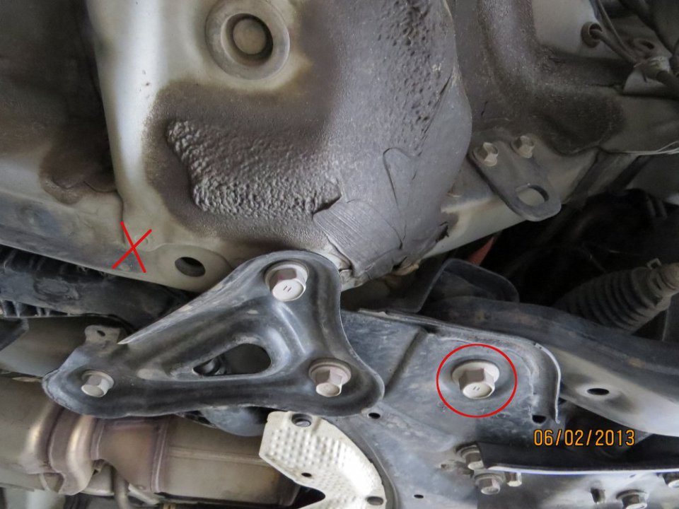

    How to level the car for transmission oil change?
    I know the car has to be level in order to fill IN the correct amount of fluid and my garage has a bit of grade level but I'm not sure if it has any significance.
    When I lift the car by front center point with my 2ton jack, I was only able to raise the car by 6.5in.
    When I use my ramp the car will be up by about 8in.
    Enclosed it the picture of the underneath are these save jacking points the circle and the X
    If I put a jack under the circle the crew will be damage I think; the "X" point with wooden block might be better choice

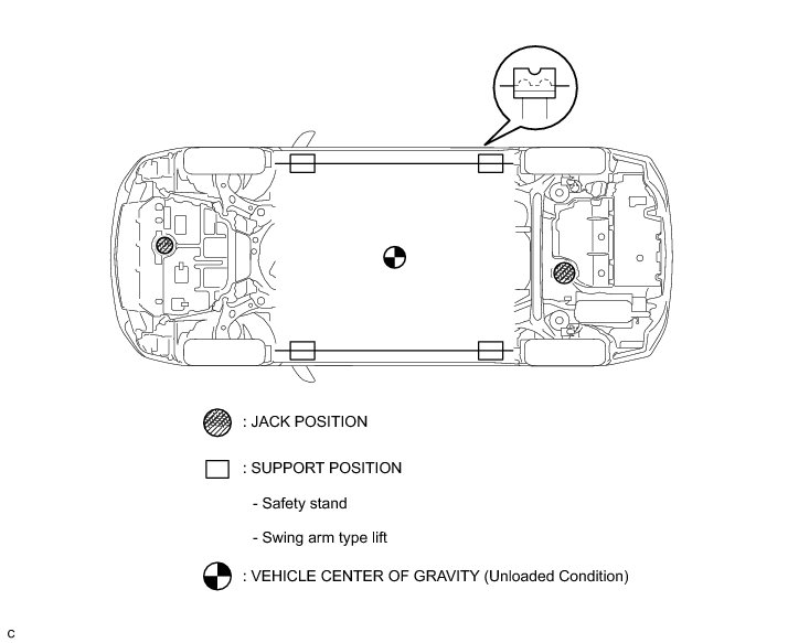

    here's a picture showing you where to jack your vehicle up and putting the jack stands.

    The X-mark is where I put my front safety stands. I put the rear safety stands per the diagram nutzaboutbolts posted above.
    My main issue was with the extra weight in the front, the shallow arch of my safety stand's cradle and the near knife-edge rocker panel edge bearing on it. Seemed skittish the few times I used those points. I think it's Hobbit posted pics of similar support location on gen 2. It works for me.
    If your garage is sloping a bit you can adjust the front or rear safety stand heights a bit to fix, or put plywood shims under the jackstands for finer adjustment.
    Do work safe. I like to push a chunk of tree stump under before getting under myself, thicker than me, makes me feel good ;)
