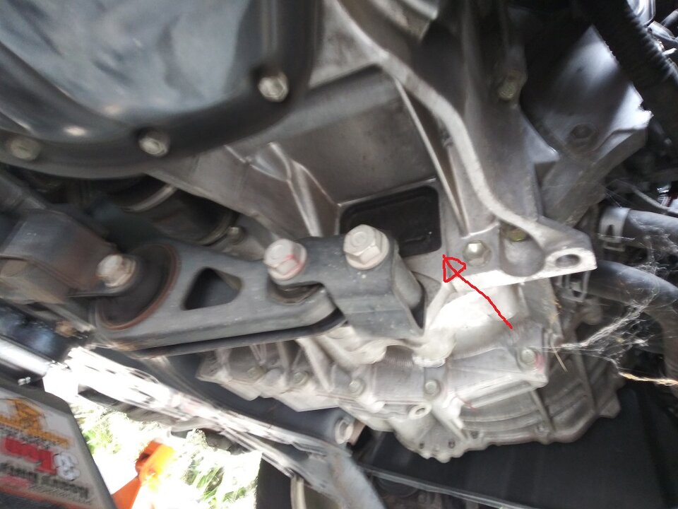

    There is a little access window on the bottom of the car that allows a view of the damper plate. Normally there is a plastic plug in place to keep it clean. It pops out and then you can see part of the damper plate through the hole. If some of the springs have broken and fallen off the parts should be right there as it is the low point in the disk shaped cavity. Given the age of that plastic plug it is possible that it will break when it is pried off, so be prepared to buy a replacement cap.

    I have had that off and tried to see in that way but it's the other side the damper is on and doesn't show much. No springs were found in there but with it off and a little rotation of the crank back and forth was a slight noise that's coming from there. Not sure if it's normal or not. I also removed the starter plug but it doesn't gain access to the damper either. Wish there was a small gap to get an endoscope in but it's too tight to see anything. Thank you.

    I'm really not sure but we will hopefully find out next week if it's loose or not. I will definitely check the flywheel nut thanks for the idea. While rotating the crank pulley and placing a finger on the flywheel through the inspection plate hole that was pictured above, it feels nice and tight this side, but we will see. Thank you.
