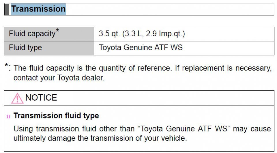

    In your dealings with Firestone, was the term "Toyota ATF-WS" ever mentioned?

    Firestone charged about $75 for the ATF change. They did indeed verify the need for WS and used one they carry that is supposed to be an equivalent according to their cross reference system.

    They probably used that Kendall Versatrans stuff. I don't think Kendall approved that for use in CVTs.
  20. Mendel Leisk
    55,551
    38,718
    ^ Yeah, this sort of thing could be a slumbering giant. Alternate fluids may be ok, case by case, but why the hell chance it.
    Then there's a certain Volt owner here, who traded in his Prius with an alternate fluid. Whoever bought that car is continuing his experiment. :mad:
