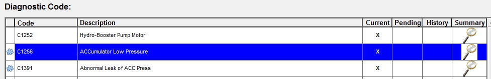

    I ran TechStream v12 and v8 (never used either before today) and got :
    ABS/VSC/TRAC: C1252 (Current) - Hydro-Booster Pump Motor
    ABS/VSC/TRAC: C1256 (Current) - ACCumulator Low Pressure
    ABS/VSC/TRAC: C1391 (Current) - Abnormal Leak of ACC Press

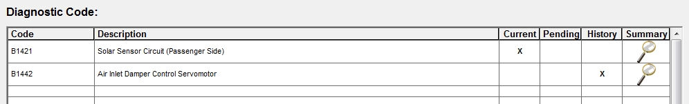

    Also got a few others that had no idea of :
    Air Conditioner : B1421 (Current) - Solar Sensor Circuit (Passenger Side)
    Air Conditioner : B1442 (History) - Air Inlet Damper Control Servemotor

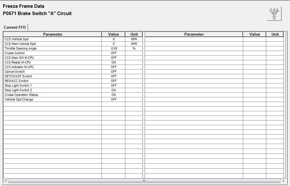

    Cruise Control: P0571 (Current) - Brake Switch "A" Circuit

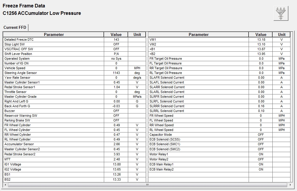

    Some Snap shots of the live data:

    You'll always have the 'current' B1421 solar sensor code if it's dusk or night (or indoors) when you read the codes.
    As for the historical servomotor code, I'd make a note of it, clear it, and see if it ever comes back.
    As for the brake codes, sure does look like the accumulator/pump, some kind of leak in the actuator, or both. You've got a Gen 2, where those are combined in one assembly anyway, so there's little point in trying to pin it down further. As JC91006 suggested, it's worth checking whether replacement will be covered under a warranty extension.

    Don't worry about the B1421 unless you know the sensor was in direct sunlight when you read the codes. It is normal to see that code whenever the sensor is shaded or in the dark, as the repair manual will tell you.
