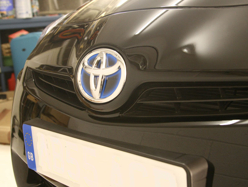

    The Toyota badge on the front of radar equipped models is smooth. On others without radar cruise, the chrome Toyota emblem sticks out while the blue background is recessed behind the chrome. A mentioned they all will have blue backgrounds beginning gen 3.
    I'll post pics in a bit.
    Radar emblem:
    Non radar emblem:

    Hmm, ok, then. From what I can tell, in the American models, it's an extra set of buttons on the wheel (occupying the right side, opposite the voice control ones), but I've not seen anything like that in any of the uk ones. Might be that those that have it just haven't wanted to give it up!
    Thanks for that. So it is possible to tell, just not easy.
