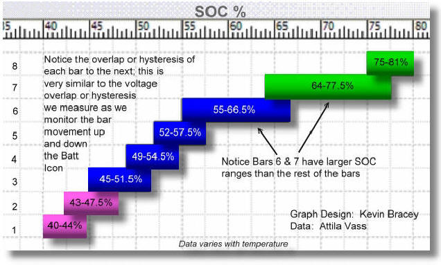

    So I suppose it is bad for the battery life to run it down to 3 to 4 bars as opposed to keeping it at 6 bars?

    no, not necessarily. its says best option is a 10% discharge. it does not mean 100% to 90%...in fact, pretty sure fully charged is not good either.
    10% can also mean running from 70% to 60% which i think you will find is just about where your Pri spends most of its time. on a Pri... well, at least on the classics, 8 bars is 80%, zero bars is 40 %...
    running between 6 bars to 3 bars is probably around a 15% change give or take.

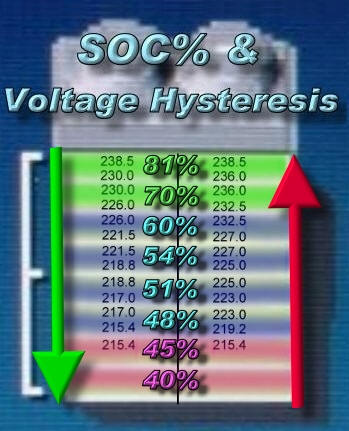

    To understand how many percent each block of the battery represent on the MFD, see the graphs below from Wayne Brown's site. More information with scenarios are available in the link I provided in my original post.
