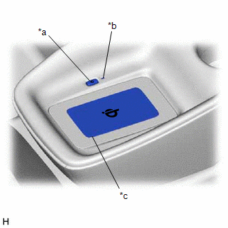

    SYSTEM DESCRIPTION
    WIRELESS CHARGER FUNCTION OUTLINE
    (a) The wireless charging system enables Qi-compatible* rechargeable devices, such as a cellular phone, to be recharged by merely placing it on the charging area of the mobile wireless charger cradle assembly.
    HINT:
    *: Qi (pronounced chee) is a wireless technology which allows devices to recharge without using any wires.
    (b) Qi-compatible devices which do not fit within the charging area cannot be used. If a Qi-compatible device does not operate normally, refer to the owner's manual of the device.
    (c) Qi-compatible rechargeable devices can be charged.
    HINT:
    • "Qi" and "Qi" logo are trademarks of the Wireless Power Consortium (WPC).
    • Although the wireless charging system meets Qi standards, compatibility with all Qi-compatible devices is not guaranteed.
    CHARGING INDICATOR STATUS
    *a
    Mobile Wireless Charger Switch
    *b
    Indicator Light (Green/Amber)
    *c
    Charging Area
    (a) The indicator light shows the operation condition of the wireless charging system.
    INDICATOR
    OPERATION CONDITION
    CONDITION
    COLOR

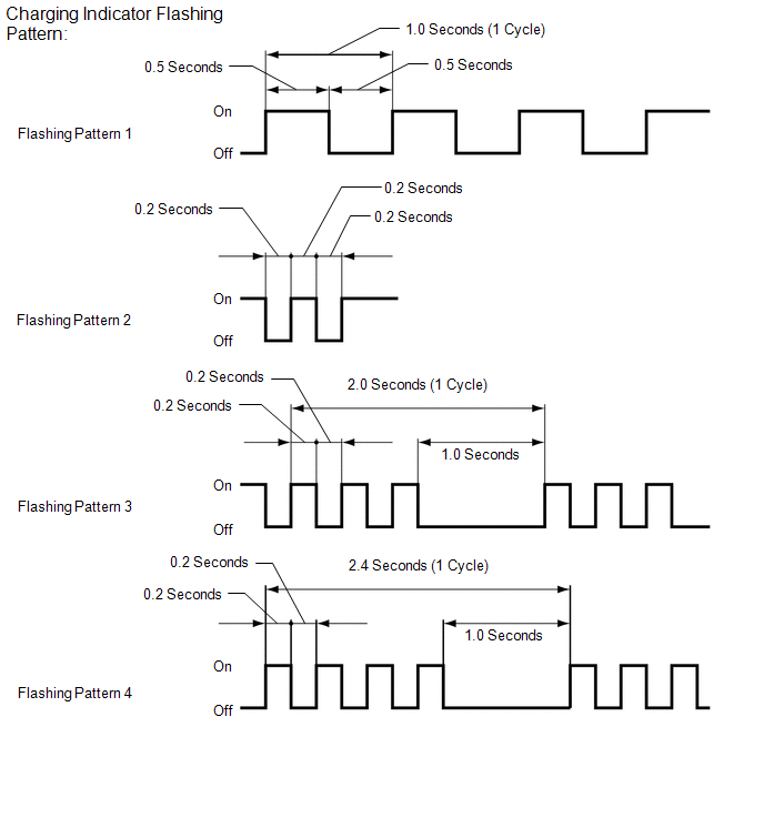

    *1: Some mobile devices, cases or accessories may not cause the indicator (green) to illuminate when charging is complete, even though they are Qi-compatible. Check the mobile device to confirm the charge status.
    *2: If the charging suspension signal is received for less than 4.5 seconds, the indicator light (green) will remain illuminated for 4.5 seconds.
    *3: Refer to the following diagram for details about the indicator blinking patterns.

    (Pattern 1)*3
    Amber
    An open in the charging suspension signal circuit is detected
    Blinks
    (Pattern 2)*3
    Amber
    The charging frequency is being changed
    Blinks
    (Pattern 3)*3
    Amber
    • Foreign matter exists between the rechargeable device and the charging area
    • A gap exists between the rechargeable device and the charging area
    • The rechargeable device is not placed correctly on the charging area
    • The rechargeable device has been moved from the position where it was first placed
    Blinks
    (Pattern 4)*3
    Amber
    The temperature of the mobile wireless charger cradle assembly is abnormally high
