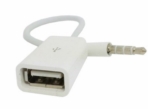

    I recently bought a 2011 Prius TWO, not II. I normally play mp3 thru a thumb drive in the other car. The 2011 Prius Two, not II, does not come with usb for flash drive mp3 music playing.
    So, I bought this! 3.5mm aux in to usb female, does not work!
    Help?
    Thanks!

    What the...?
    OK, best case, you bought a doohickey that requires specific support from the car to work right. You cannot just directly connect USB to audio, for a variety of reasons:
    • USB has 4 wires (power, ground, Data+, Data-), normal audio jacks only have 3 (Right, Left, and Ground). Their connector obviously has 4 contacts, so it's not obviously a total fake, but the Prius undoubtedly only has the 3 I mentioned. (Some devices, like the iPod/iPhone, do use 4-contact jacks, so that they can support a microphone and/or remote on the audio jack; either 3- or 4-contact plugs will work in them. But the iPhone certainly doesn't support USB over the audio jack, even if it has the right number of conductors.)
    • Audio signals are analog, USB signals are digital. If you listened to the data going over USB, it would just sound like white noise (like a waterfall, or the static between radio stations).
    • The USB drive requires 5 Volt power on the power connector to be able to turn on.
    • etc, etc, etc.
    Now, although I've never seen such a thing, it would be possible to make an AUX jack that could detect if you had connected one of these adapters, and speak USB through it. Maybe somebody makes such a radio, rather than just taking the easy route of putting a USB jack next to the AUX jack. But the Prius radio is not one of these.
    It would also be possible to make such a doohickey work in theory for any AUX jack, but it would require a battery and a small chip to decode the audio and output it to the audio jack. It would not be as small as what you have there.
    Worst case, you bought a cheap piece of garbage that the seller knows will never work, but is so darn cheap that the seller also knows you won't go through the hassle of returning it, so he gets to keep your money.

    Thank you for answering this post. I thought I would try it since it is not expensive. You are right that the seller/maker will not have to worry about returning this product, it was shipped from: SHENZHEN EMS CHINA thru the mail.
    It is now obvious to me after learning from your post that it could not have been so easy and the maker of this thing is certainly aware of that.
