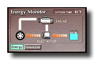

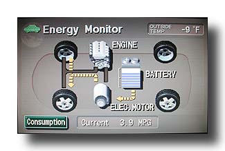

    Scanguage didn't exist back when Classic owners were still looking for an aftermarket tool. I know that very well, because I was one and desired that. It's why you aren't finding any info. Too late.
    Coolant, LOD, and RPM would still be quite useful. I don't use SOC or voltage for my HSD now, so I'd never miss it on a Classic anyway. MPG is especially handy, since that older version Energy Monitor doesn't include it.

    Thanks John. What do you mean the MPG is not on the energy monitor of the old one? I'm assuming you must be referring to some specific readout for it, not just the standard mpg trip meters that are on it already, or the energy bar graph?

    [​IMG] Classic
    [​IMG] HSD

    And yet, despite the fact your HSD screen says -9F outside temp, it doesn't bother me.... (fellow Minnesotan).
