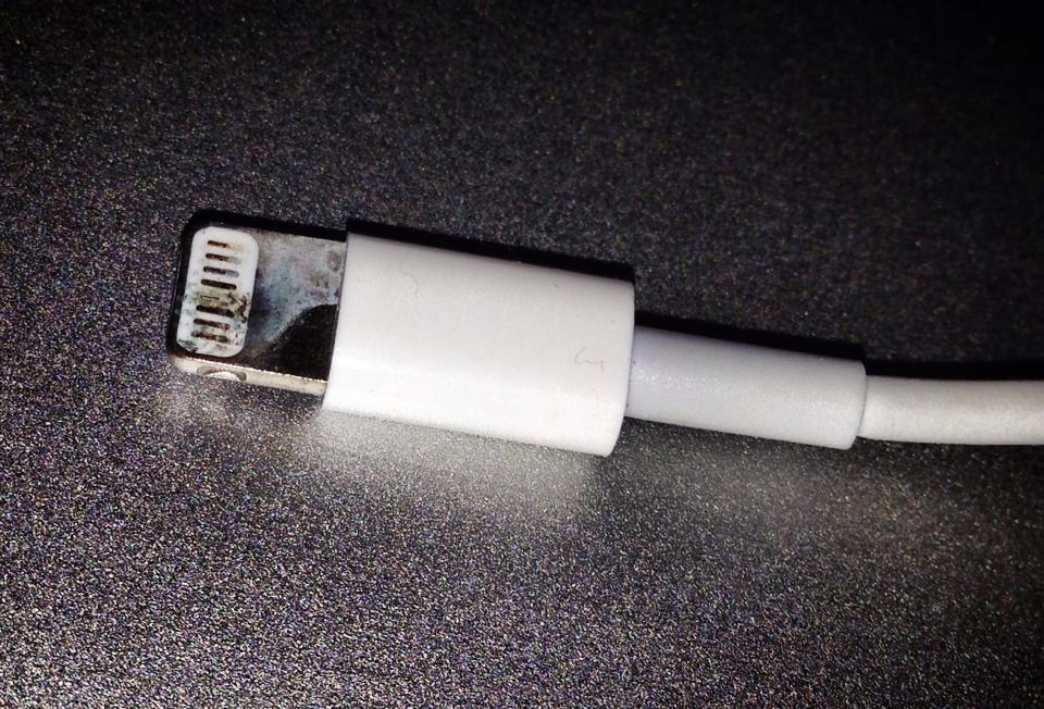

    Has anyone had a problem with Apple lightning sync cables shorting out or smoking after plugging in an iPod or iPhone into the 2013 Prius' built-in USB port? The cable starts to smoke, suit covers the cable and the 4th pin's contact flakes off. See attached photo.

    Get a compressed can of air and blow the USB socket on your car. Maybe something got lodged inside and it's causing a short circuit. Looking at the pic, it looks like the terminal got shorted. Have you tried plugging a different iphone/ipad on this car? I have been using mine with no issues.
