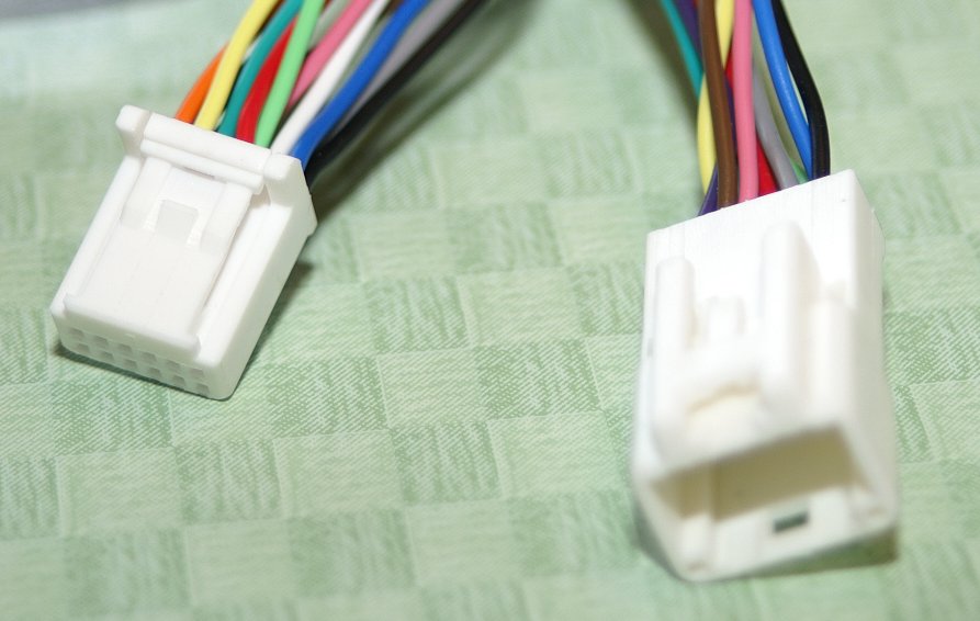

    Bob,
    Sure:
    Mike
  7. BobR
    BobR Member
    Jan 16, 2005
    336
    It looks like the correct cable to me.
    Bob
  8. mbarrows
    mbarrows Illini Bird
    Jun 22, 2004
    210
    Frankfort, Illinois

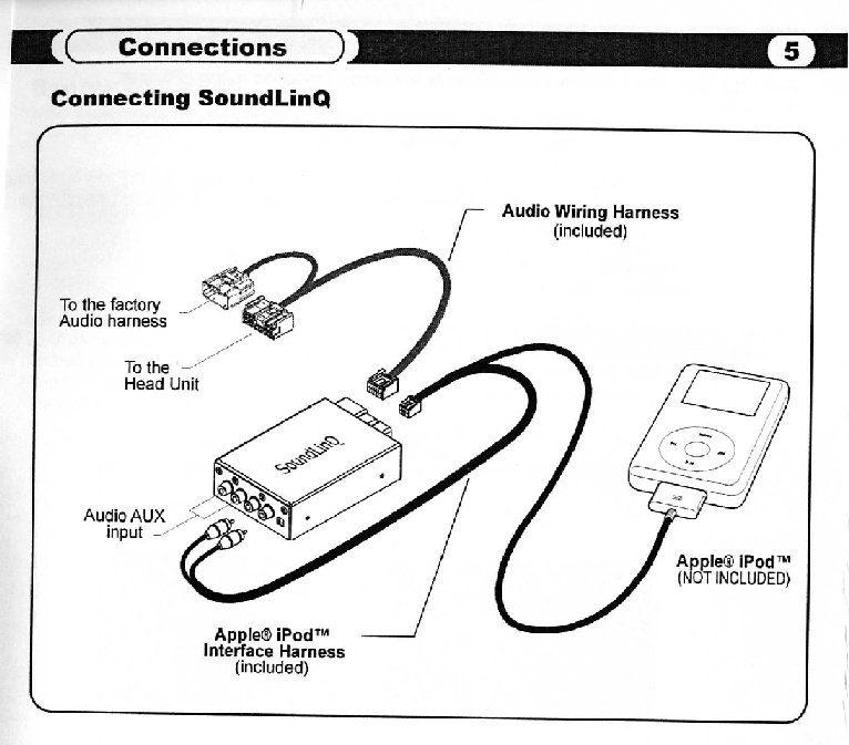

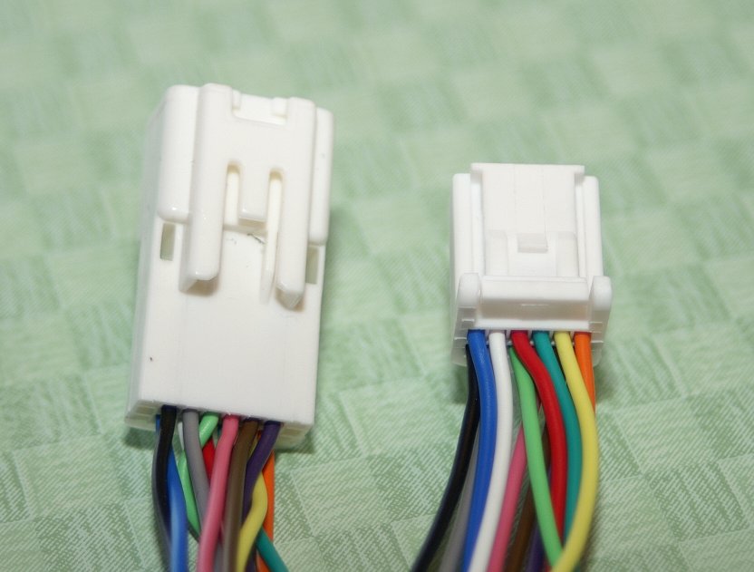

    No Bob, it isn't. It will not fit in the plug where the existing connector is. I wish I could get a picture of the plug that was pulled out but it's too far under the dash to see well or get a digital shot of. If you look in the VAIS AIC-100i installation instructions, it shows a plug that DOES fit. The existing plug on the head unit is more rectangular & flatter.

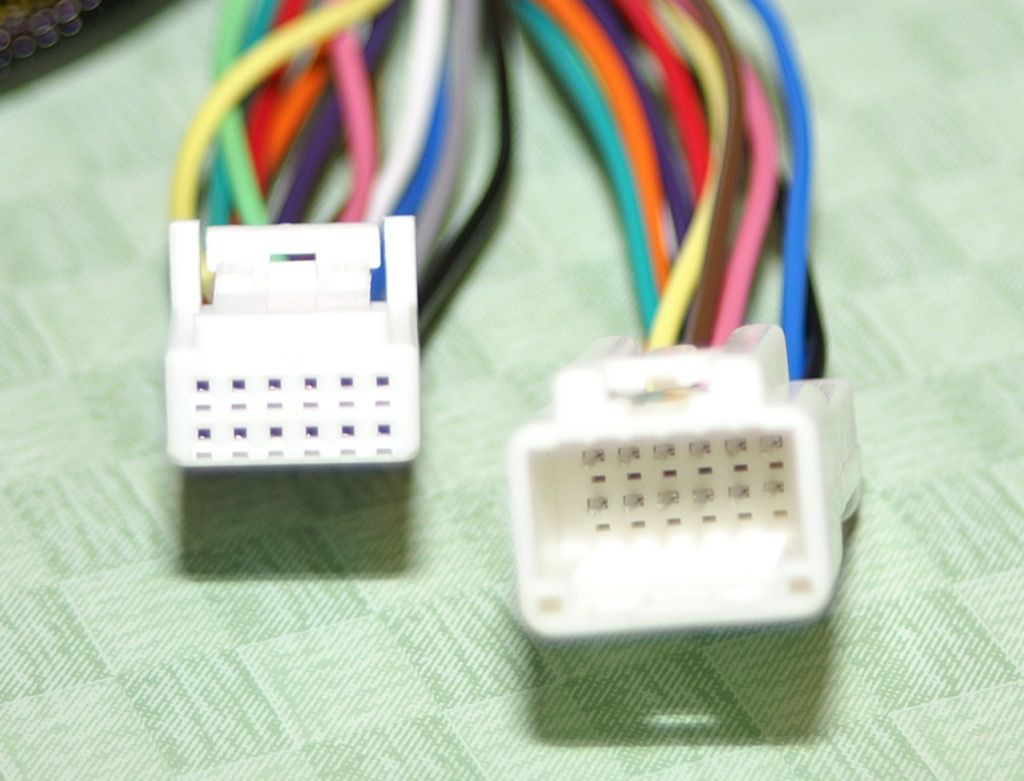

    Unless you have an external changer or Satellite radio, there should be nothing in the connection on the radio.
    This is what it should look like:
    [attachmentid=949]

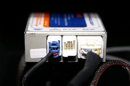

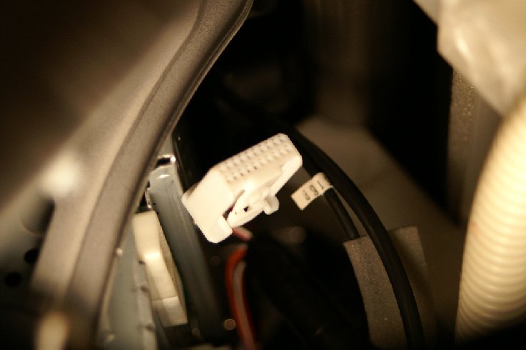

    This is what my plug looks like after I pulled it out (first socket):
    No external changer; no satellite radio. The directions say it plugs into the first socket and not the second. Your picture seems to show the second socket; is this correct?
  11. naterprius
    naterprius Senior Member
    Mar 15, 2004
    1,843
    Yes, that is the right connector. If you don't have XM, Sirius, or an external CD changer, the port is open on the back of the stereo. Let the male version of the plug hang loose behind the dash, plug the female portion into the radio.
    FYI: Gender is determined by pins, not be pin housing.
    Nate
  12. mbarrows
    Jun 22, 2004
    210
    Frankfort, Illinois
    Nate,
    There is an open port but it's the second port and the directions indicated pulling the plug out of the first port. Which port does it connect to?
    Mike
  13. BobR
    BobR Member
    Jan 16, 2005
    336
    You don't have to unplug anything, unless you have an external changer or sat radio.
    Just plug the cable into the open connection.
    Have you read Craig's instructions?
  14. mbarrows
    Jun 22, 2004
    210
    Frankfort, Illinois
    Bob,
    Yes, I used Craig's directions with the exception of where the VAIS directions say to unplug the first connector and install it there. Well, this is wrong! Craig's directions are correct where you don't have to unplug anything. The unit works fine and I want to thank you, Nate & Craig for the help. Ironic, PriusChat.com has the correct instructions and VAIS has incorrect ones.

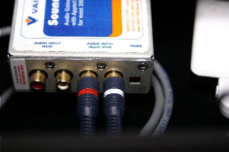

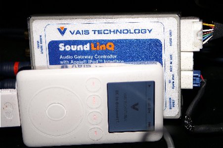

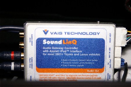

    From what I can tell (and I've never actually seen a real AIC-100i) the SLI and AIC-100i are very similar. The SLI has an integrated sound grounding loop adapter in it. It also has two "dip" switches for either "CD" or "MD" mode emulation (which you have to set once installed; mine is in "CD" mode emulation as I think it displays more text - song title, etc.). There is a electronic sound level adjustment you can do on the iPod so that the volume always starts at a preselected value (1 to 31). The case appears to be an aluminum one held together by screws and can be opened. There is a service port (covered) which I believe VAIS can use for firmware upgrades. As I found out, their installation directions are incorrect as they show plugging their unit into the first head connector when really it's the second one (arrow is pointing to wrong head connector).
    Bob, PM me your e-mail address and I'll send you the album of SLI pictures.
