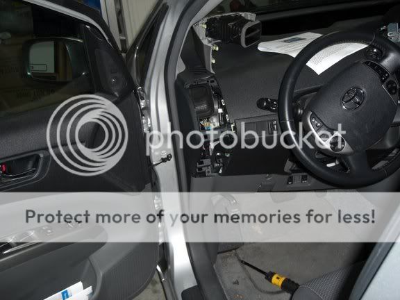

    My driver's side (left side) vent controls are a little bit askew. Can someone tell me the safest way to remove this panel so I can investigate what is going on in there? Here is a pic I poached off this site of the panel I wish to remove.
    Thank you in advance.

    Looks like you already removed it...

    Nope, that is a picture I stole from this site. I can assure you that my vent panel is still firmly attached. I just don't want to break anything getting it off.
