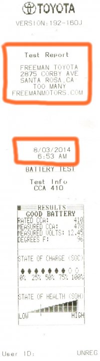

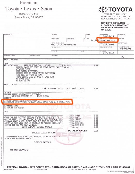

    Earlier today, I brought my car into my local Toyota dealer for a free inspection. Yes, it's amazing what people will do to get something for free, such as me willingly leaving my car at the mercy of the Dealership. Anyhow, onto the very important information that was bestowed upon me once the inspection was complete…
    1. My car is Driftwood Pearl in color. In the past, I typically described it as a tan/brown/gold sort of color, but now that I know that it is in fact Driftwood Pearl, I’ll be sure to correct everyone when they call it something else. If nothing else, it will make me look smart (assed).
    2. Fumoto valves suck – I paid $28 for a fumoto valve from Amazon, thinking that it would make my oil changes easier and less messy. Obviously, that was a mistake and a waste of money, as indicated by the knowledgeable Inspector’s comments:
      Rec(commend) replace aftermarket/ “Spigot” style drain valve with normal drain plug.
    3. There are too many Toyota Dealers. Alternatively, the zip code of my local Toyota dealer is “TOO MANY”. They must have applied for and been subsequently issued a special zip code from the post office. I’m not sure which scenario is correct or which I like better. I’d better call the Dealership first thing tomorrow for clarification.
    4. The correct date is 23 days earlier than everyone else seems to think it is (even the computers at the service counter). Fortunately, the guys in the garage know the correct date.
    I sincerely hope that my fellow PC members will pass along this invaluable information that I have taken the time and effort to attain. Thank you very much!

    While I can appreciate the humor, I have to give the dealer some credit
    1) He could only know about the spigot valve if someone actually looked. (I have been told I needed to get a new cabin air filter...after I put in a new one two days previously. I actually raised my voice about that.)
    2) I don't see a long list of questionable services. That is the most impressive thing about the list.

    Let's see if I understand this. Your battery has considerably more amps and volts than stated on its label, but they list it as being seriously discharged and in a very low state of health?

    A fully charged 12v lead acid should measure 12.6v. Fully discharged one is around 11.7v.
    The state of health rating likely includes other details not listed. Such as; charge and discharge rates, and the capacity.

    I've run some tests on the battery myself, and it is definitely on the tail end of it's life. Resting voltage (after the car has not been driven for several hours) is usually about 11.9, and it discharges quickly when placed under a load. It is still reliable for the time being, but I'll likely have to replace it within the next year or so.

    Why play Russian Roulette (Battery version) when you can proactively get the replacement battery at a lower cost ahead of time vs. paying max price. The cost of having you Prius towed or serviced at maximum cost will not make up for the extra days, weeks, or (unlikely) months you have left. I have a 2001 Prius and I can assure you a dying 12V battery causes far more difficulties in a Prius than a dying 12V battery does in a conventional car.

    Or just get the replacement, and keep it with required tools in the car.
    I now try to give our car batteries a top up charge about once a month at least. It can take a traditional starter battery 20 minutes of driving to charge back up after starting a car. With all the accessories cars now have, the battery likely never gets fully charged. The deep discharge battery in a hybrid like a Prius should handle it better, but it is a smaller capacity to begin with.

    I'm skeptical of those oil drain taps, never had a problem loosening a bolt. And a bolt seems a lot more secure. That said: those guys are REALLY ballsy removing that, without even contacting you.

    They didn't remove it, they just suggested that I replace it with a regular drain plug (which I have no intention of doing). It screws in tight like a normal plug, and you can secure the valve with a clamp if desired.

    Ah, missed the "recommendation" text in the bill.
