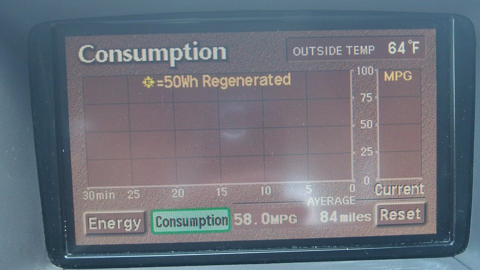

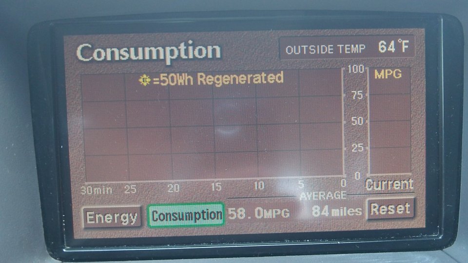

  14. bwilson4web
    28,600
    16,152
    A used Prius is an excellent way to get into the technology:
    The gray line is the best predictor of NHW11 (2001-03 model) MPG as it incorporates the vehicle overhead along with drag functions. You'll notice the green diamonds, my earliest mpg vs MPG chart, shows a knee that starts at 65 mph (104 km/h) giving 52 MPG (4.52 L/100 km.) Best of all, with the accumulated experience here, we can help you keep that car running as long as you're willing. Just understand a used car will have unplanned, maintenance and repairs instead of high, initial purchase price.
    I continue to use our 165,000 mile (264,000 km), 2003 Prius as the experimental test article instead of my wife's 57,000 mile (91,000 km) 2010 Prius. But it was the 2003 Prius that led us to buying the 2010 Prius secure in the knowledge that it would be a great ride. Here are my favorite pictures of both cars:
    That is 1,700 lbs (773 kg) of trailer and airplane, my other hobby.
    If (when) you get the Prius, please update your profile with your location. The reason is we have a lot of knowledge about climate and terrain effects on older Prius. Most of all, we want to help you catch up on maintenance items that might have been missed.
