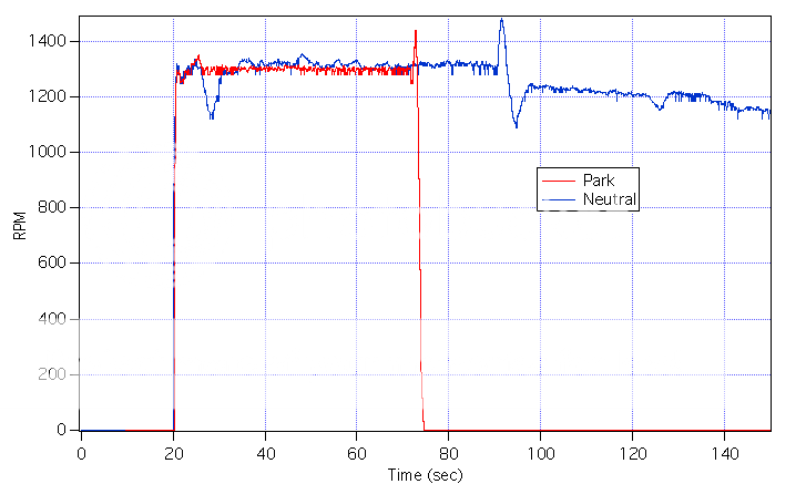

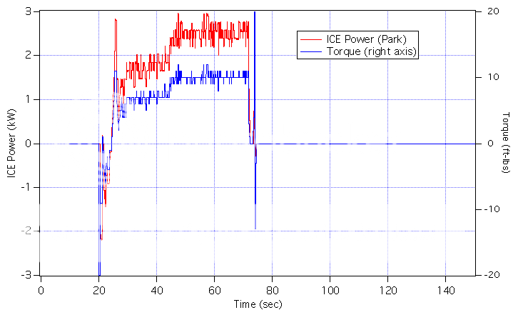

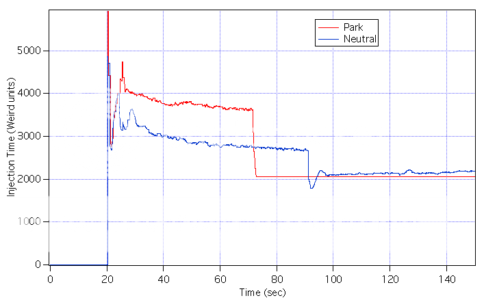

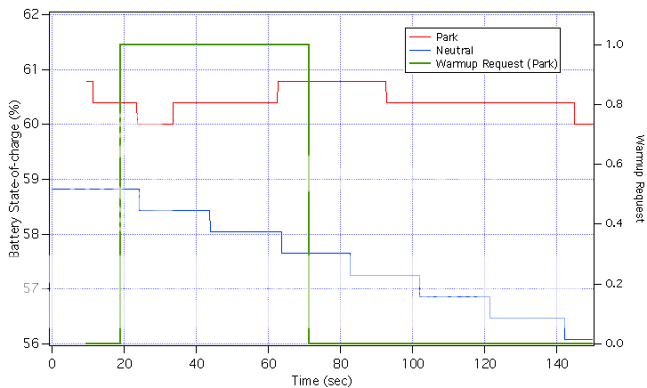

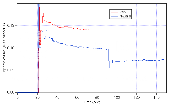

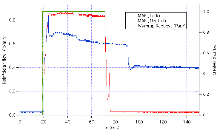

    That is really interesting. You inspired me to go back and measure the ICE power during the warmup cycle and log the data. I also tried to replicate your Park vs Neutral data. However, interestingly, with the car in Neutral, the ICE never starts until I put it Park (or drive), then I can put it in Neutral. Even more interestingly, there is a PID (#692) in the Engine ECU (234) that gives a boolean value for "Request Warmup". I've put this on some of the plots below. For the "Park" condition, the "Request Warmup" exactly indicates the stage 1a time from ICE start to ICE stop. For the "Neutral" condition, the request warmup indicator is TRUE at the same time as the Park condition, i.e. about 8 seconds after the power button is pushed, but the ICE does not start the stage 1a warmup until the car is actually shifted into park or drive. Weird.
    Anyway, here are some graphs of the data I took. This is for a GenIII (ZVW30) manufactured Oct. '09.
    The first is of the ICE power (in kW) with the car in Park. The ICE runs but it is generating very little torque. The ICE torque is on the right axis and it peaks around 10 ft-lbs. The spike of negative torque (and thus negative ICE power) at the beginning of the warmup cycle is MG1 spinning up the ICE to start. It peaks at about -100 ft-lbs.
    The 2nd graph is the MAF (Manifold air flow) for both the Park and Neutral conditions. This is similar to Bob's injection-time as it is related to the amount of fuel consumed. As in Bob's results, the Neutral condition uses less Fuel/time, but stage 1a lasts longer, and the ICE doesn't shut down after stage 1a. The MAF data doesn't account for changes in enrichment so it isn't an absolute measure of fuel consumption, although after the engine is warmup up the canonical air/fuel ratio of 14.7 almost exactly reproduces the instantaneous fuel gauge on the Gen III MFD, at least as far as I can tell by eye. Note that I've also plotted the parameter "Request Warmup" for the Park condition so you can see how well it corresponds to the ICE running. The "Request Warmup" for the "Neutral" condition isn't plotted but it corresponds exactly to the fall in the MAF at around 90 seconds.
    The 3rd graph is the battery state-of-charge for both the Park and the Neutral conditions just to show that the battery charges in Park but not in Neutral. This was, of course, expected. The Warmup Request for Park is plotted again.
    The 4th graph is the RPM data.
    The 5th is interesting. This is a parameter entitled "injector volume (ml) Cylinder 1" (ECU 234, PID 115). I have no idea if this is ml/injection or ml/time. I can probably figure it out by knowing the cylinder volume and the canonical air/fuel ratio. I'll work on it. However, it looks a lot like Bob's injection time plot, as it should…
    The 6th plot I had hoped would be the same as Bob's plot. I used a parameter called "Injection Time (D4)" (ECU 234, PID 116). I have no idea what the "(D4)" means and the units are quoted as "81s" which I also don't understand. However, comparing the values to Bob's chart it would make sense if the units were in 0.1 ms. At the moment this is a mystery
    Okay that's enough fun for now. Note that all the data were taken with a DashDaq mounted on my dashboard and written to SD card. The data were plotted in IGOR on a Mac.

    I think it's ml/sec. If it were ml/injection, it would be 0.15x700=105ml/min per injector at 1400 rpm.
  15. Prius42
    Prius42 New Member
    Mar 20, 2010
    139
    Maryland
    Yes, I came to the same conclusion as follows:
    From the MAF data:
    MAF = 0.85 lbs/min of air
    MAF/cylinder = 0.21 lbs/min = 95 g/min of air
    air/fuel ratio = 14.7
    gasoline density = 0.72 g/cc
    ==> fuel consumption from MAF = 9.0 cc/min = 0.15 cc/sec
    Which is precisely what the injector volume PID is giving. That is just great since now we have a direct measure of fuel consumption and I can also calculate the enrichment from the MAF data and the injector volume! This is great!
    Now we can integrate the data in graph 5 and get the total fuel consumption for stage 1a in Park and Neutral:
    Park = 34 cc (for all 4 cylinders)
    Neutral = 24 cc
    This is what it takes to heat up the catalytic converter, and in the first case to charge the traction battery by ~0.8%. Cool!
