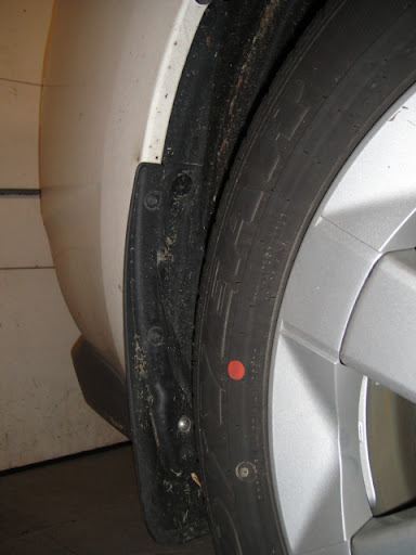

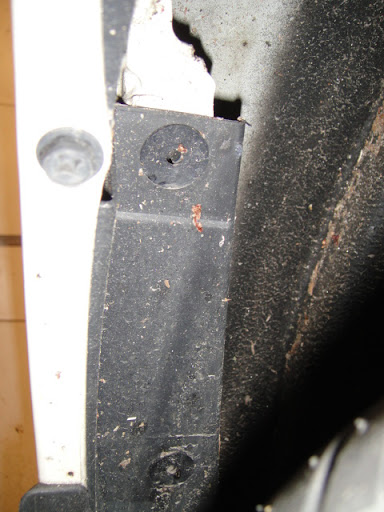

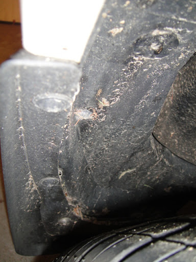

  14. 2009Prius
    2009Prius A Wimpy DIYer
    Mar 25, 2009
    2,705
    510
    63
    Interesting. It looks like your car had a piece of plastic missing which you replaced with the white plastic. Did you buy the car new? Has the car ever been in the shop for repairs? Here are some pics for comparison: Your car:
    Mine: Note the black piece on my car that matches the location of the white plastic you added on yours:
    There is a mud flap but it covers only the edge of the bumper cover, roughly where the 4 ">" signs are in your photo, and it does not cover the "gap" shown in your photo.
    Close ups: Top:
    Bottom:
    Maybe you could ask your dealer's parts department and see if they sell the missing part on your car. Good luck!
