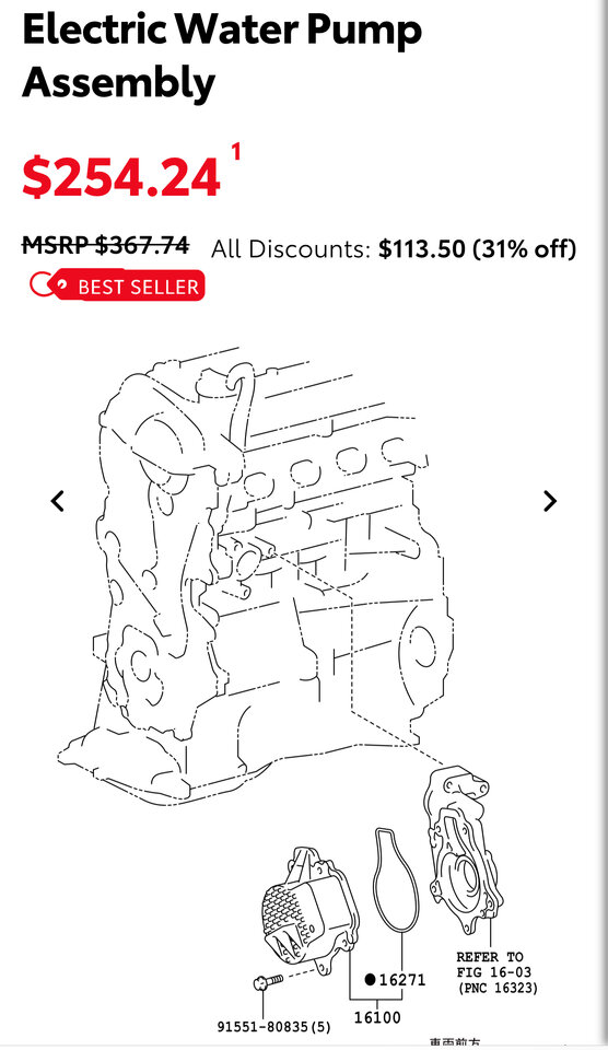

    This pump is electric and is as easy as an oil change to replace... There's plenty of videos on how to do it on Youtube and you only have to drain coolant down a small amount. If you or a friend or family member has basic car maintenance skill, there's no reason to spend alot of money on this job.

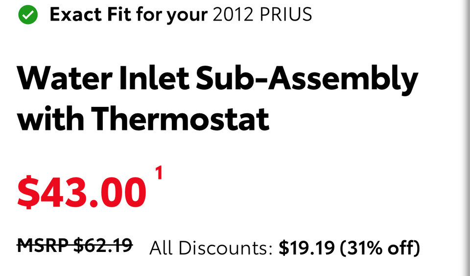

    What is Thermostat housing? Just thermostat or housing is different?
  9. BiomedO1
    BiomedO1 Senior Member
    Mar 27, 2021
    2,958
    1,577
    SacTown, Ca
    One piece unit - old American cars are two separate units.
