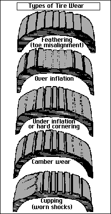

    Any of these look like your tires?

    No. Tread looks normal and then there is a large wear spot that is followed by three or four similar spots that decrease in depth and width.
    A little less than a third of the tread circumference is affected. Shocks are still good. This type of wear pattern started to occur when the car was new.
    The last two sets of tires developed the same wear pattern. One was a set of Goodyear TripleTreds and now a set of GoodYear RS-As.
    I found a subtle binding when rotating the rear hubs, especially the rear right (passenger) side.
    And yes, I will once again have the alignment checked. Everything was well within specs the last time the alignment was done.
