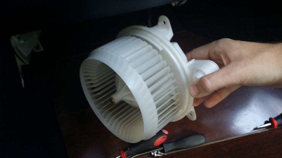

    Found the culprit... I'm not sure what's wrong with it but basically it randomly "throws itself off" then makes that awful sound. I don't know if I just buy a new one or what. Car is 7k over the 50k factory warranty so I don't know if it's something the dealership would replace.

    Blower motors do go, so just shop around for a new one.

    But I dont know if I should replace it or if it maybe can be fixed? It doesnt do that sound all the time and a temporary fix is turn ac off and then back on and its gone. Even though I know thats obviously not going to fix it.

    They don't fix themselves and I don't recall ever seeing one that you can get replacement parts for. Shop around for a good price and put a new one in.

    You could just replace the blower motor instead of the entire unit. The part is also used in other Toyotas. You'll save some by avoiding sites selling the Lexus part.
    Car Part LEXUS 8710375021, MOTOR SUB-ASSY, BLOW
    If you can replace the cabin air filter and use basic tools, the unit is behind the glove box with the filter. How to's are on the web.

    Thanks everyone for the help yeah I already had pulled it out I think I might try spraying it with some wd-40 first to see if that stops the squeaking

    i had this problem with a squirrel cage motor in a gas fireplace. the mating surfaces wear, creating wiggle in the cage. you probably need to replace it.
