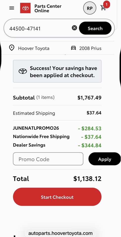

  13. rjparker
    rjparker Tu Humilde Sirviente
    Jun 6, 2008
    10,830
    6,799
    Texas Hill Country
    Is this for your 2008 Prius? I see
    44500-47141
    or the lower cost tsb kit
    04003-44647
    Often you can't go by the number on the housing
  14. ChapmanF
    28,511
    18,848
    Here is a link to that correct part number, ➡44500-47141⬅, where in one of the photos you can see there is a different number on the housing, not the part number, and that different number ends in -47051.
    Many people mistake those numbers on the housing for part numbers. (eBay and salvage sellers often list the parts by those numbers, because they see them on the housing and they don't know better.)

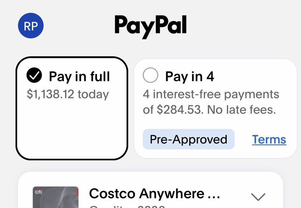

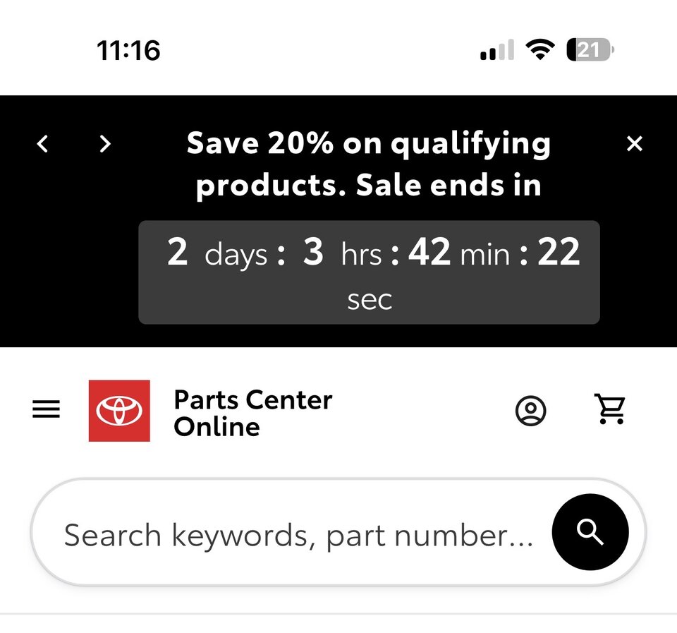

  17. rjparker
    Jun 6, 2008
    10,830
    6,799
    Texas Hill Country
    Buy new from an online Toyota dealer. You add your vin and the dealer will verify. Prices and shipping vary widely.
    Paypal often allows 4 equal payments interest free
