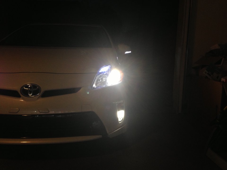

    Installed high power LED head light bulbs.

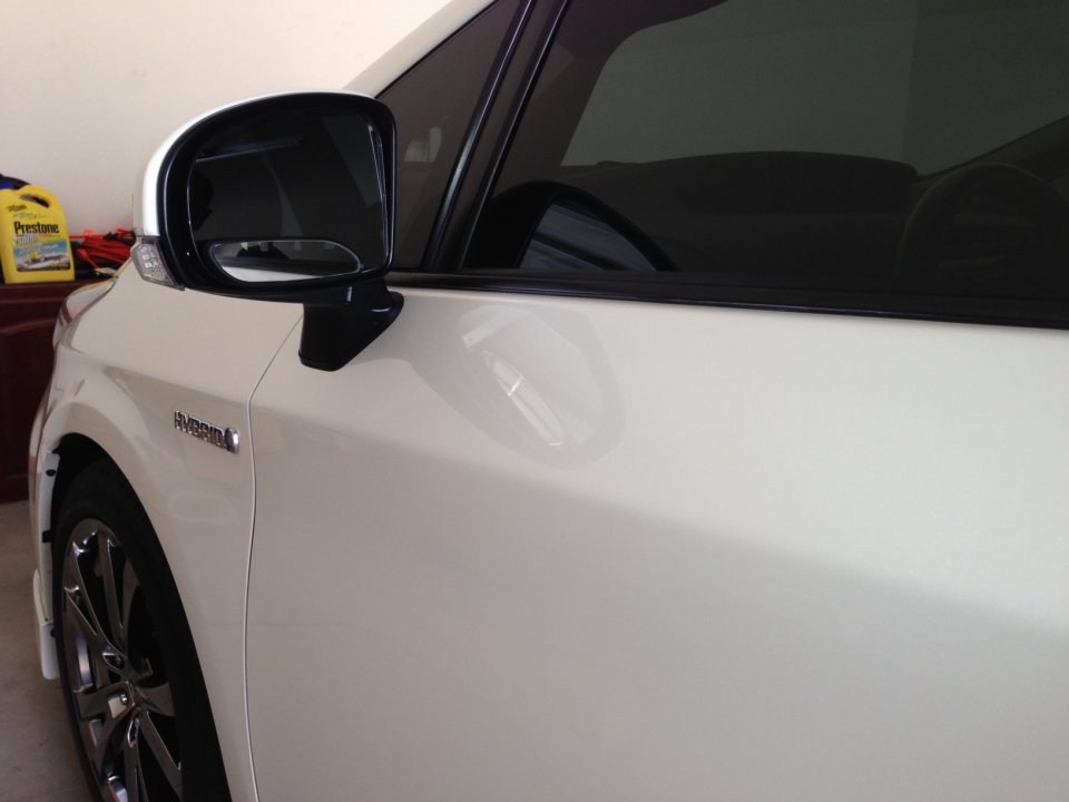

    installed blind spot mirrors

    yes with a dimmer.

    Do you have any pics of the bulb?

    Any special ballast or harness required? I like the intensity of these.

    comes with ballast. The set up is just like an HID kit.

    Details (watts, lumens, etc) please, and links. :)

    You can go to ebay and seller is RSI LED lighting.

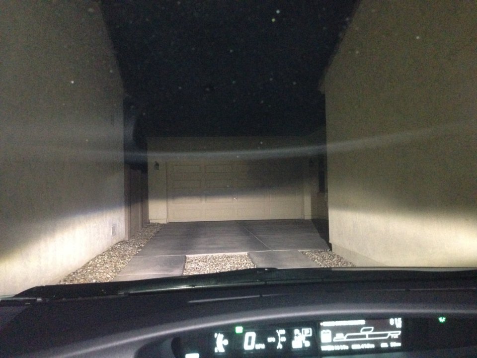

    These are Cree LEDs, so they're typically 5w each, and there's 2 per light. So only 10w each light. Description says they're 20w, so they must be talking about both sides total.
    They claim they're 2x brighter than H11 bulbs at 1900 lumens, but H11 bulbs are about 1350 lumens, so kind of shaky math being used. :(
    It's good to see that a small cooling fan is mounted on the base of each bulb because heat is bad for these SMD LEDs. 30k hour service life is pretty optimistic considering the application, and the warm environment in the engine compartment.
    Please review your impressions Dawit after driving around with these for a while. :)

    I have been driving with these for about a week now. They produce a much brighter light than the HIDs I had. So far haven't had any problems.
