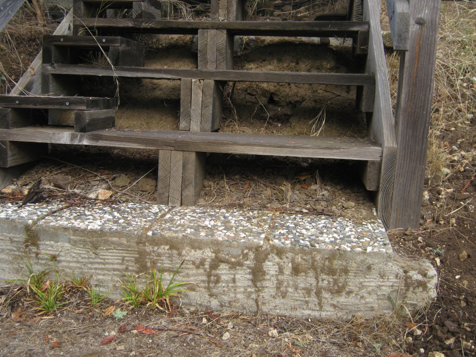

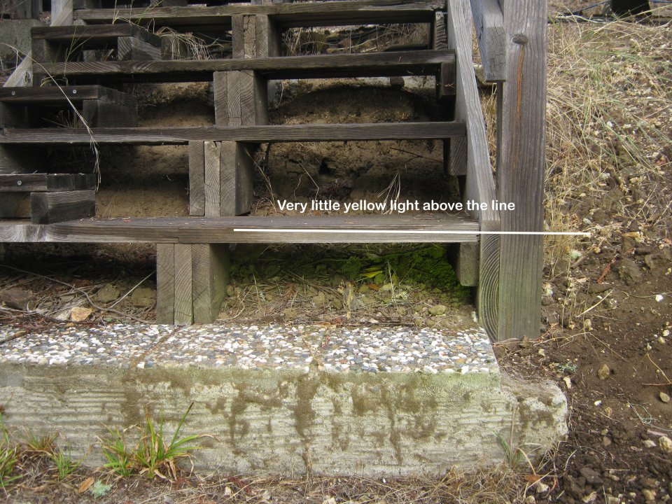

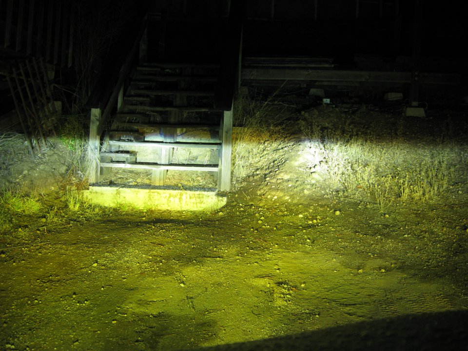

    No fog lights on:
    With only the HID fog lights on:
    The car is sitting approximately 4" below the bottom concrete step. Tough to see in the daylight, but the yellow light really shows behind the second step on the hillside, with very little light going above the second step. After it gets dark, I'll take a few more pics to see where the cutoff occurs as compared to the headlights.
    The idea came from an image I found on Amazon for LED fog lights...

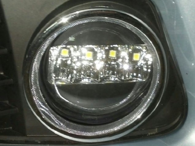

    What the heck is that!?
  8. sfprankster
    sfprankster Active Member
    Sep 25, 2014
    444
    490
    Santa Cruz Mountains, CA
    A Cylon from Battlestar Galactica?

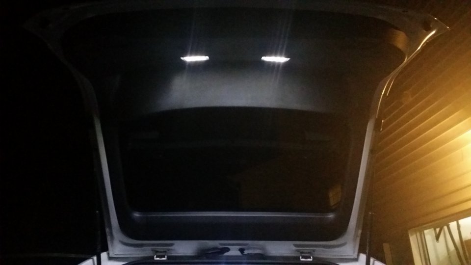

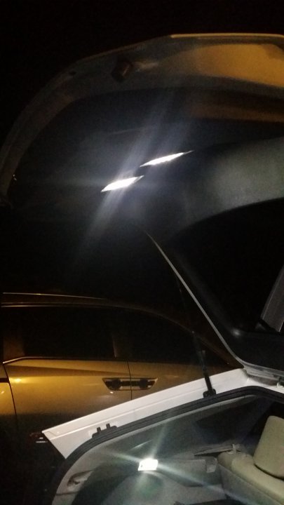

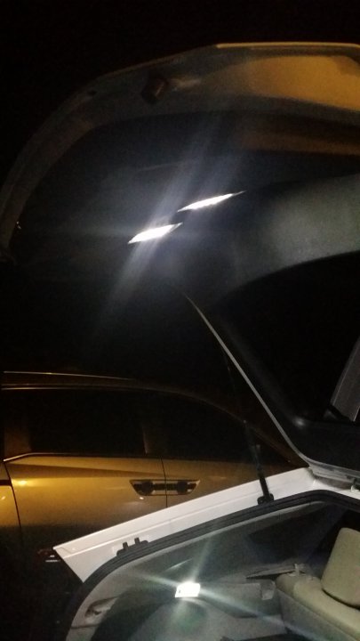

    OK I'm a dummy... cargo leds working now after the fuse was blown because the wires touched during install because of the plug coming off when it was shipped in the box! It was wrapped in the white paper and I didn't see it until today. Oopps sorry @sfv41901 for wasting your time asking u questions on this!

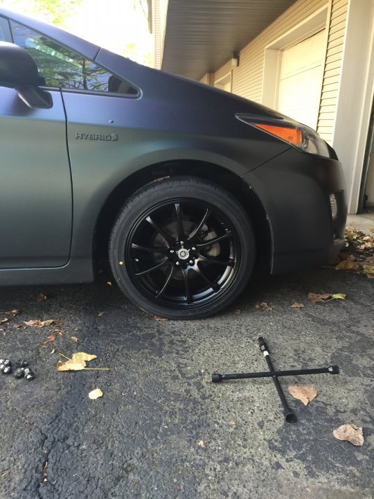

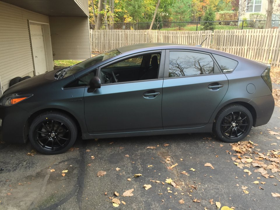

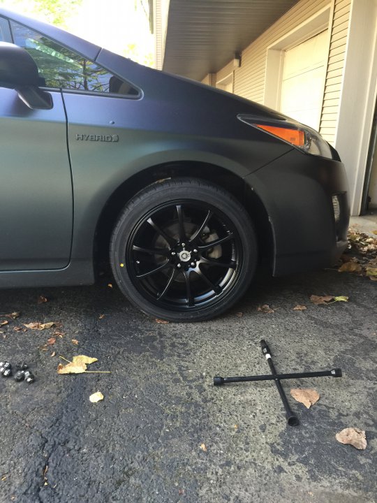

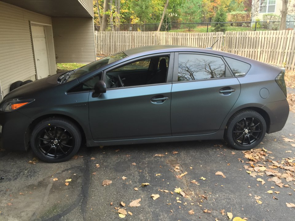

    image.jpg Put on my new summer rims, konig feathers 17x7.5, will rock them for a few weeks and switch back over for winter. Couldn't wait 6 months and not see them on.... I know it's 4x4 status but I figured I'd wait till after winter to put my springs on image.jpg
    Ramtart, RightOnTime, Burna J and 2 others like this.

    What's that above the Hybrid emblem.. a zit? on both sides lol
  15. rcs3434
    rcs3434 Member
    Apr 29, 2012
    56
    163
    Danbury, ct
    Lol, never thought of it like that..... It's a toyota logo sticker that was part of the pin strip that was on the car when I got it, never thought to take it off when I dipped it.

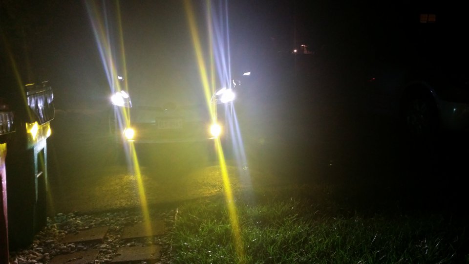

    Update pics, taken without a flash or any additional light sources, of the 3k HID fog lights, w/cutoffs, and 5k HID headlights, showing the overall light pattern:
    No more yellow light is showing from the fog lights, in the overall light pattern, above the 5k HID headlights pattern.
    ckam1989 and xliderider like this.

    What's the distance between the stairs and the lights? If it's too close, the lights could be rising, but it may look ok. Increase the distance, and the light might be able to spread up more. If it's about 20 to 30 ft and no stray light above lowbeam cutoffs, then yes, I'd say glare is gone. ;)

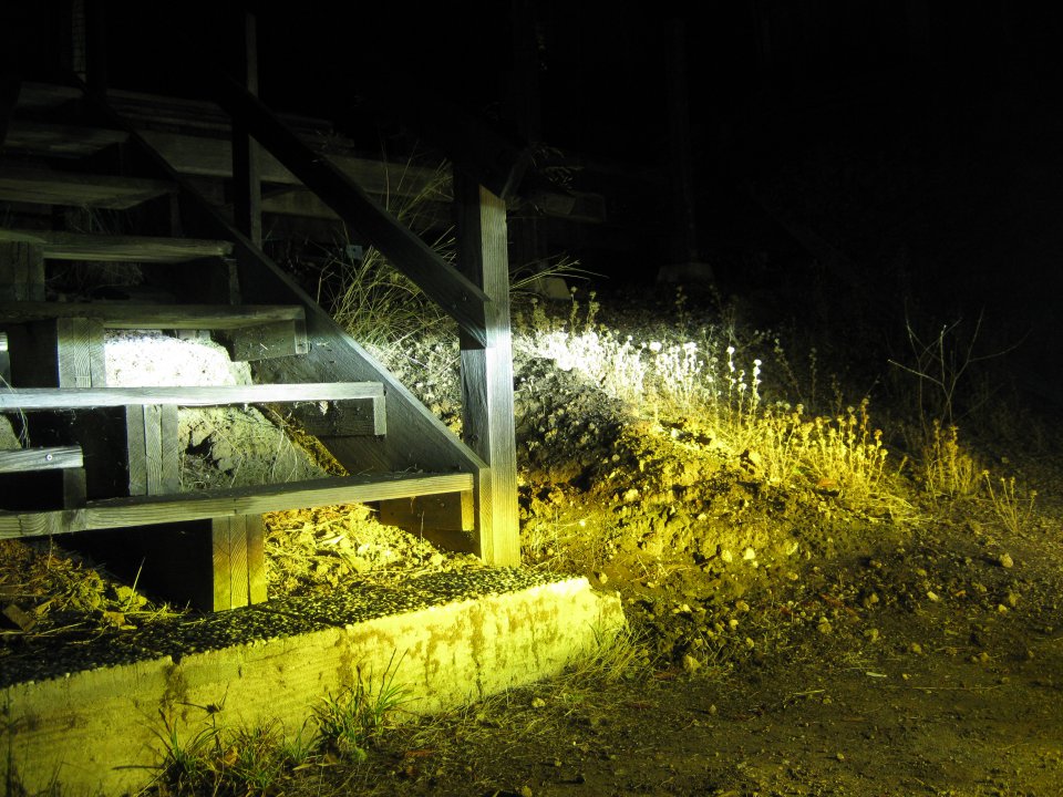

    Pic taken with the car backed up 26' from the stairs/hillside, from the hood of the car:
    Just the slightest amount of yellow light showing above the headlight pattern cutoff from the fog lights. I can adjust the fog light to project a lower pattern on the housing itself.
