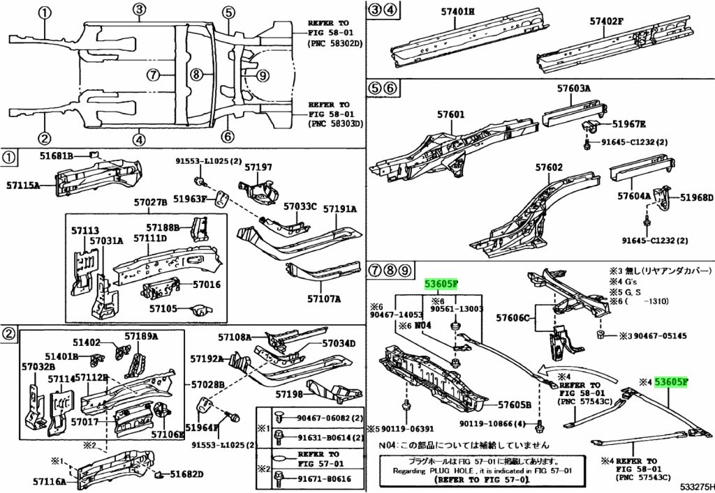

    It's Toyota part number:
    5360547020
    It's:
    53605-47020 Toyota Brace sub-assy, rear suspension 5360547020.
    It's the diagram part reference 53605F in the image below (lower right).
    Note that Toyota has two similar parts with that diagram number.
    Code:
    https://static.amayama.com/schema/toyota-5360547020-1565857802024-big.jpg
    Good Luck!
