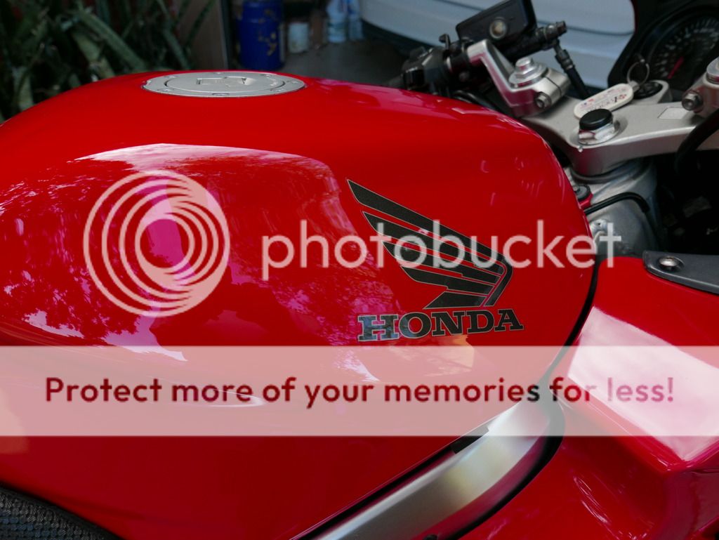

    15 year old neglected paint. I started with a wash with a mild degreaser and then two coats of each: rubbing compound, polishing compound, scratch remover, and carnuba wax. Approximately 7 man hours of labor (hand applied and electric polisher with foam pads).

    Nice bike! I rode a lot during my teens and early twenties. I had an accident in 1979 while living in England, 50 miles north of London. Kind of ruined it for me. I was lucky and walked away with just bruises (I T-boned a front fender and went airborne for about 25 feet, hit the ground hard and slid for another 10 feet.)
    My last ride was a friend's Goldwing around the block in 1985.
    I bought a 2 seat sports car before my 30th birthday, and that became my rush. Acrobatic flying worked too. I just didn't enjoy driving in traffic with so many people not looking for bikes.
    Driving at 100 mph plus on a hot bike is a rush. Enjoy!
