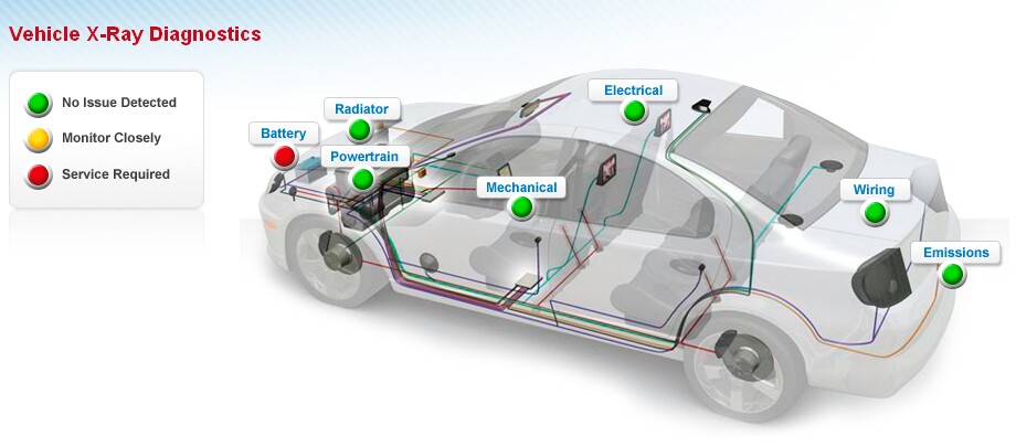

    I don't know how to get into any diagnostic screens on Gen III, but I do have a driving monitor from my insurance company (I'm sure this could start a long side discussion, but this is a battery thread). It does include some diagnostic capabilities. I could pay extra for full access to scan codes, but even without that, they do give me this basic maintenance summary. The car isn't displaying any battery errors on the dashboard, but this thing is. This is my current status:
    If the computer internally recognizes a fault it's not showing on the dashboard, maybe the dealer will also be able to read this and confirm a battery problem. I expect though after my long drive back to the dealer, the battery will be recharged and be back to green (that's how it's been going with this thing).
