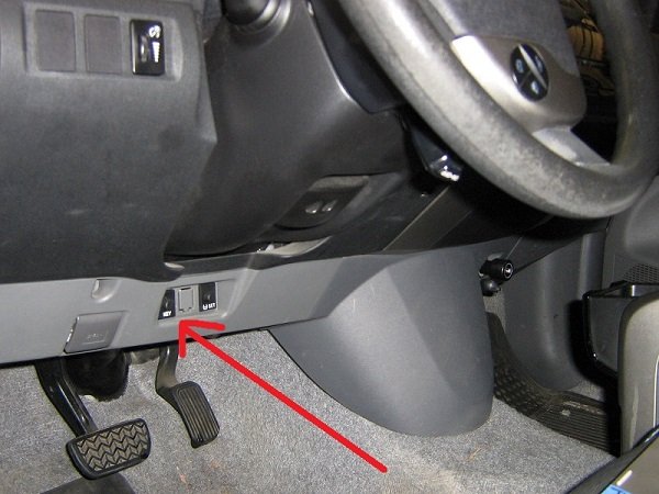

    It is better to check to see if you have a 'Key' button below the steering wheel column. It is present, you have SKS and need the more expensive fob with the silver logo. If it is not present you need the cheaper fob with the black logo.

    looks like I need the more expensive key. My key fob is working now. I do have a spare that doesn't work tho
