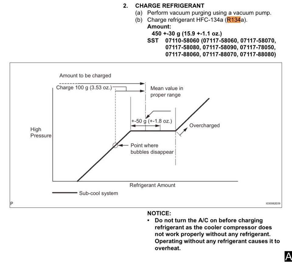

    It's a variable pressure system so the people who refill based on pressure are at risk of causing damage... Seems the people who top off just a little don't have much problem. But its properly done by evacuating entire system and then putting in a specific weight of lubricant and specific weight of refrigerant.

    The AC system in the prius is pretty delicately balanced and wants a precise amount of refrigerant to deliver real results. Save topping off for the last summer trip before you sell/crush the car.
    If you're just trying to get it to leak so you can spot the leak, you probably don't need to pull a vacuum. Save that for after you've really fixed it and you're doing the real charge.
    Condenser. They take rock hits, people back into them, and sometimes they just corrode. Beware cheap aftermarket condensers; there are some really crummy counterfeits out there that cost little to buy but your system will have much less cooling capacity, especially on the hottest days.
    When the refrigerant leaks out it won't leave marks, but when it pushes the ND11 oil out with it that will leave a mark and the oily spot will attract dirt quickly. So you're looking for oily dirty spots on the AC plumbing.
    Remember, it's a finicky balance. You want to use a very accurate scale to weigh the refrigerant as you feed it in for the final fill- try to get within a few grams for full performance.

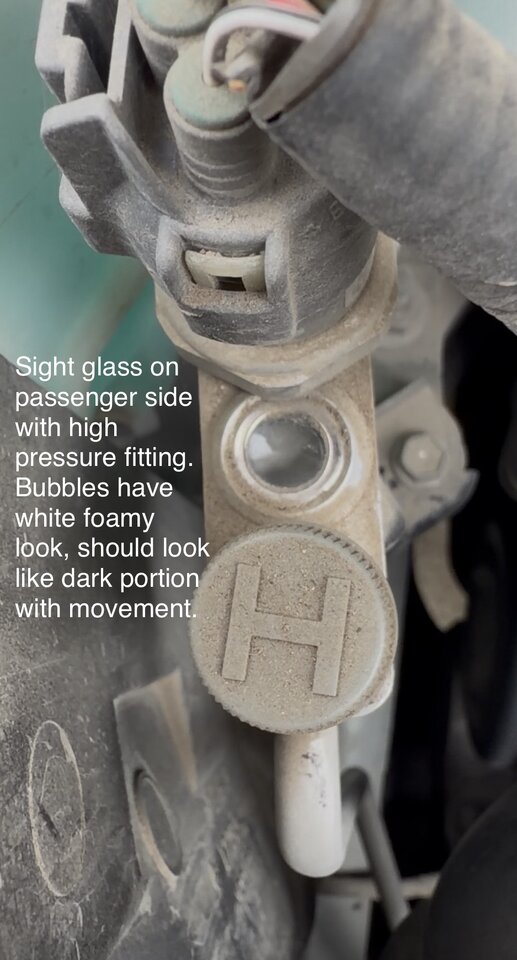

    Purge the line from the can to the fitting to eliminate air and then slowly add while watching the sight glass to clear. AC on. Do not overfill; stop when the bubbles clear.

    System sealer is bad a few ways around. Again, the system is very carefully balanced, built to use the minimum amount of refrigerant to deliver performance through the normal service life of the car. Changing the interior volume of the system (space taken up by sealers) is going to upset that balance. The sealers can possibly have chemical reactions with the (different from most cars) ND11 oil. And lastly there can be electrical reactions with the electric compressor.
    The bad news is that with a finicky system like that, the way to make it work at all is to make it work right, and that can be a big bill on an old car.

    Don't over think this. Carefully add clean refrigerant until the sight glass clears. Cold air capable of cooling a very hot cabin in 5 minutes should be the result if the compressor is still good (normally bullet proof in a gen2 unless...).
    If it lasts 3-6 months you know its a slow leak. Rinse and repeat when needed.
