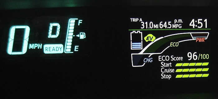

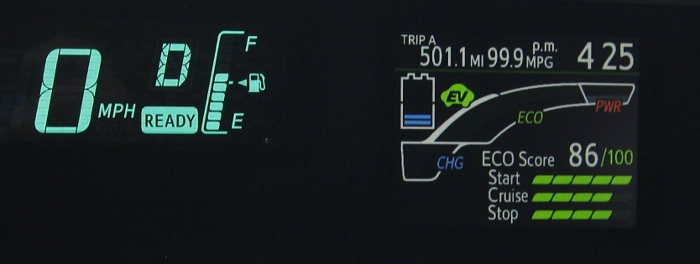

    Please be aware that the eco score is calculated ONLY from the time the car accelerates from a COMPLETE stop until the car stops COMPLETELY the next time. That's it! You may drive 500 miles and get over 100 miles a gallon and still show a lousy eco score because it has recorded a distance of 50 feet between the two last COMPLETE stops. After playing with it to see what it likes for starting off (very light pressure on the accelerator, preferably battery only) cruising ( very gradual accelerations, lots of gliding and coasting) and stopping ( again a glide or coast with a delicate pressure on the brake until the complete stop) I have paid scant attention to the eco score. It's simply not that important and pretty much useless except as a teaching tool - Not that there is anything wrong with that.
