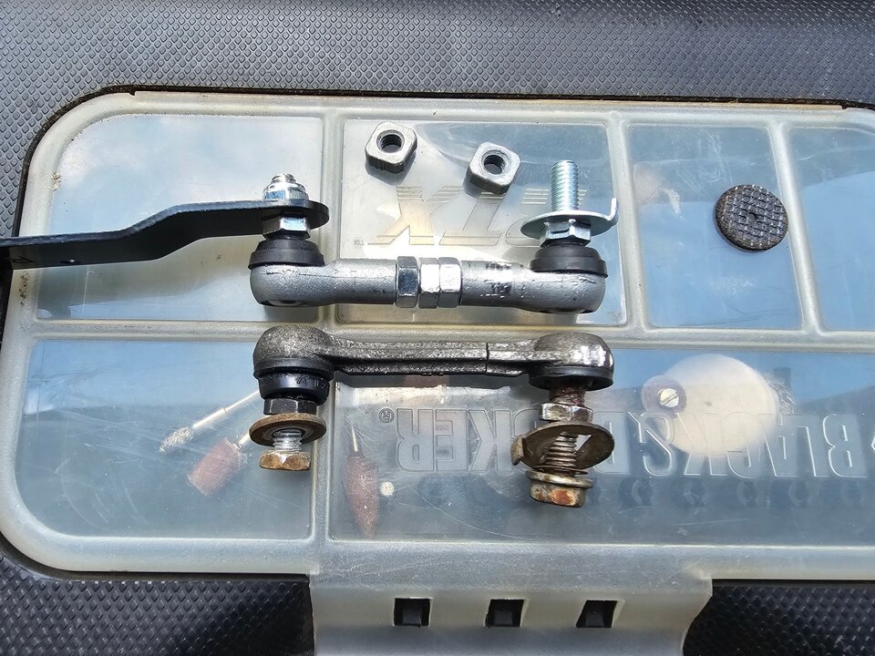

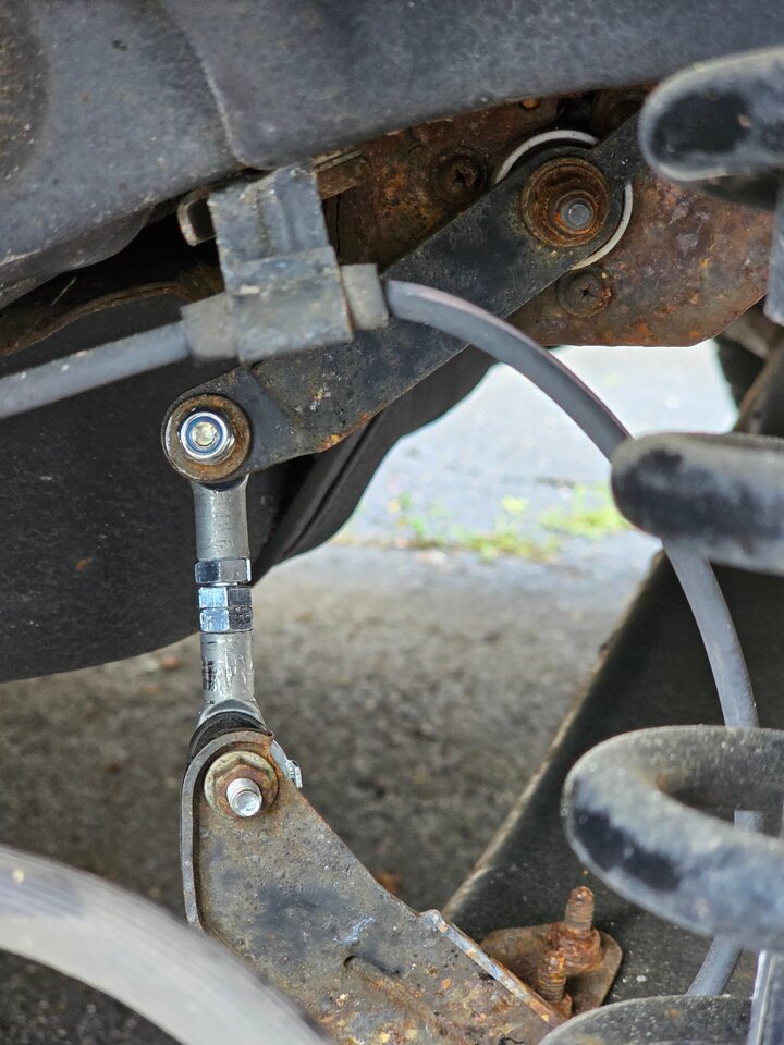

    Just replaced the linkage that was sitting around all winter. I put off the installation because it was a bit longer than OEM. Finally found time to cut it down with a dremel and matched up the length.
    Linkage installed.

    That replacement part looks good.
    The rust, not so good.
    In the second picture there are two bolts facing up which look like the nuts have already rusted on. Would be a good idea to treat that rust before it gets worse. At least hit the rustiest areas with some squirts of "Fluid Film", or a similar product.
