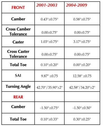

    Correct, rear alignment on a Prius is not adjustable w/o a crow-bar or other method of actually bending parts at the rear wheel.
    Front alignment is limited to toe as camber/caster are fixed based on how the strut is attached. You can adjust camber somewhat if you use "crash bolts", which are lobed and can be turned in a particular orientation to affect overall camber. Generally, these are used for cars with slightly misaligned frames after an accident.
