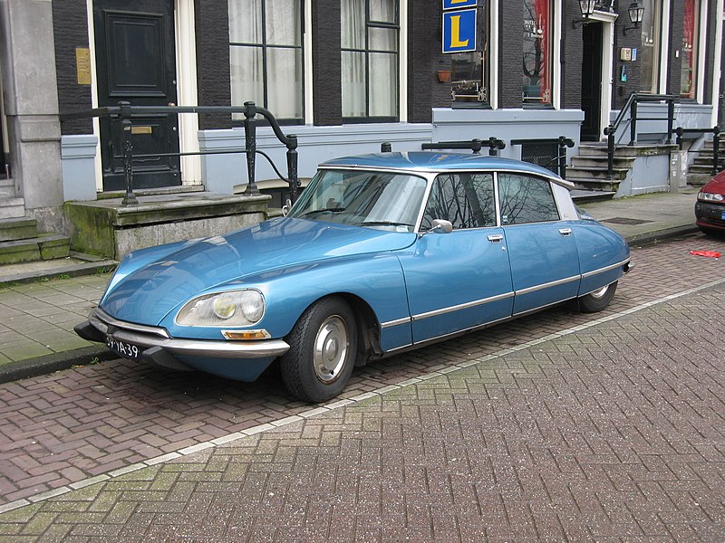

    I agree with that and just find wheel skirts not suiting the Prius very well,
    The prius is already not as stylish as an Audi for example, but the wheel skirt don't add style at all imho...
    This is not only this one, all wheel skirts that I manage to see on priuses are the same to me...
    I tought wheel skirts were a brilliant idea on old citroen cars...
    but not on a prius...
  13. Rokeby

    Tchou,
    Thanks for the pix. The black Citroen looks somewhat like a stretched Prius!
    IIRC, the Citroens share one characteristic with the Honda Insight: the rear
    wheel track -- distance between the wheels -- is less than in the front. This
    would allow the skirts to follow the curving body line from top to bottom.
    In the case of the Prius, the rear wheels stick out past the body work in
    their lower half. This means that the skirts cannot follow the curving surface
    of the bodywork. The surface of the skirts forms an almost flat plane that
    falls straight down, with wedge shaped pieces filling in between the flat
    outer surface and the body. It's the only way it can be done. Check the final
    pictures in the first post in TheForce's thread;
    http://priuschat.com/forums/prius-modifications/50902-review-hybrid-effects-wheel-skirts-3.html
    I note that the lower edge of the skirts on the blue Citroen follows the lower
    edge of the bodywork. This is essentially how the unmodified Hybrid Effects
    skirts look. Because the HE skirts stick out about 2-1/2 inches past the lower
    line of the bodywork, the resulting line of bodywork and skirts is not as
    "clean" as on the Citroen.
    However, the lower edge of the skirts on the black Citroen are "lifted" above
    the lower edge of the bodywork. This is the look that I'm going for.
