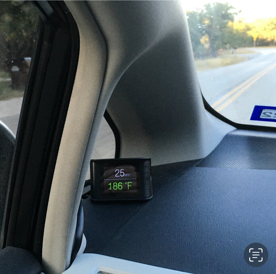

    I would get an obd2 scanner or dedicated monitor with a lower audible alarm and watch it carefully.
    Normal is 195f even at 130 kmh (81 mph) increasing to 205f under severe ambient and load. The warning light comes on at 248f. P10 monitor $35 alarming at 78 mph and 210f.

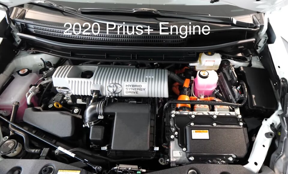

    European v's (prius+) usually have a third row and lithium batteries in the console upfront. Which is why they had a roof rack carrier.
    They were sold through 2021 in some countries and occasionally JDM gen3 1.8s from Japan can be fairly new.
    2020 Prius+ Engine
    #9 rjparker, Aug 18, 2025 at 2:17 PM
