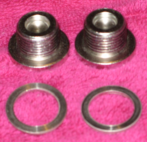

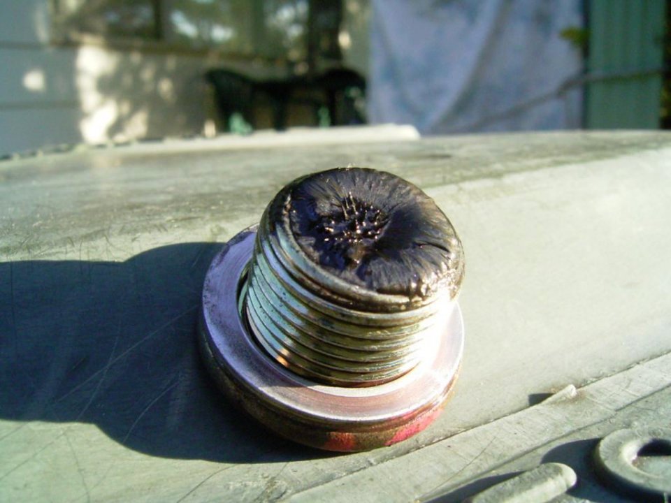

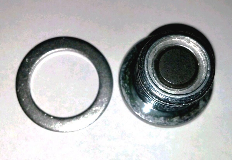

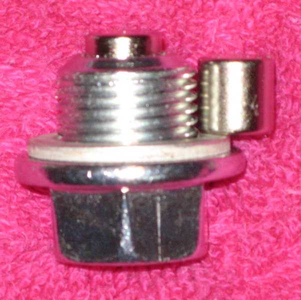

    I recently changed the transaxle fluid in my Gen III Prius"v."
    Unfortunately, I found that Toyota no longer installs the small ceramic magnet in the drain plug.
    I have uploaded photos of my two plugs,
    an older type of drain plug with a small thin ceramic magnet,
    a magnetic drain plug removed during a transaxle draining from a Gen II Prius.
    Note the large amount of steel and iron removed from the transaxle fluid. Suspended and circulating, it has got to increase wear in the gears of the transaxle.
    So, I am glad that I drained the transaxle, installed NEW WS fluid and added a high strength neodymium rare earth magnetic drain plug.

    No sir, no magnet. All three plugs I removed during my 100K service (two for the transaxle fill and drain and the inverter coolant drain plug) were all the same each with the same aluminum crush washer.
