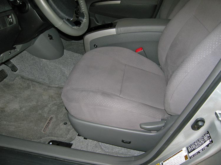

    Look toward the front of my center console.
    Form my lumbar and heat page:
    http://evnut.com/prius_seat_heat.htm
    (caution... my domain is about to migrate to a new server, so if links don't work, try again later).

    Oops, sorry not to have gotten back to this. There aren't many options for moving it around from that location - there are some items in the way behind there - like the cup holder mechanism. Also, the higher it is, the more likely it will be accidentally hit, I believe. I love having them there, and would do it again if needed. I was going to put them on the seat skirts, but I wanted to be able to reach both of them from each seat since my wife often forgets to turn hers off.
    Not sure I understand - if you are taking about my installation. I put the switches in like you say. Up is high and down is low.
    As others have said, this is pure BS. It would be the same as a stereo installation voiding your warranty. NOTHING can void your whole warranty except maybe putting the car through a crusher. :)

    I'm guessing some people are confusing the lumbar support switch (on the seat skirt) for the seat heater switch. (I almost did, and I've read your seat heat page before)

    Ah... so it didn't help to have the caption, "Look toward the front of my center console?" Oh well... so my pictures are only worth 500 words. :) Time to draw in some arrows to make it more obvious!
    Thanks for the nice words. That page in particular certainly isn't in the category of "how to." I just wanted to get some relevant info and some tips up there to help folks do it themselves.
    Tough to make a good time estimate since I just fit in the projects when I can... plus I only had to take the seats out once to do both jobs which was a bonus. I figure probably four hours when I was all done.
